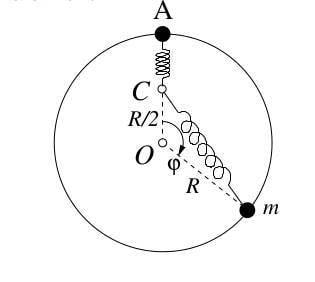

Here is the problem.
A small ball of mass m moves without friction attached to a cwire.
The ball moves under the action of gravity and a spring of constant k whose other end is fixed in the point A, with OA = R / 2.
The spring is tension free when the spring is R/2
to. Calculate the potential energy of the mobile as a function of the angle φ.
B. Calculate the speed at which the mobile must be released in position with free tension of the spring so that the ball can go around.
The system is on the horizontal plane.
Solve also in case it is in the vertical plane.

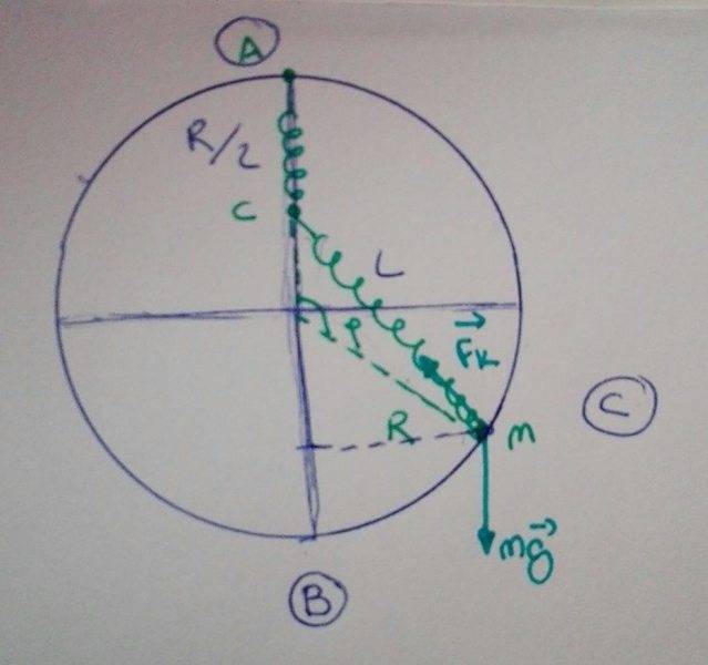

I have put AP distant as function of radio and radio/2. Because of the cosine theorem, ##c^2 = a² + b^2 - 2abcos\phi##, I wrote ##L^2 = (R/2)^2 + R² - (2R^2)/2 cos\phi## --> then, ##R \sqrt{ ((\frac{5}{4})- cos)\phi)}##, where L = AP.
So, analyzing the energy in the points A and B, (see the new draw, I have put the potential energy origin in B, and the maximum in A, beeing the circle in vertical position)
Energy in A:
$$Ep_a=2mgR$$
$$Ec_a = \frac{1}{2} m(v_a)²$$
$$Ee_a= \frac{1}{2}K (R/2)^2 = 1/8 kR²$$
Where, Ep is potential energy, Ec kinetic, and Ee the elastic one.
Energy in B:
$$Ep_b= 0$$
$$Ec_b= \frac{1}{2}m(v_b)^2$$
$$Ee_b =\frac{1}{2} K(R+(R/2)^2) $$
Doing ##Ep_a + Ec_a + Ee_a = Ep_b + Ec_b + Ee_b##, and ##v_b= 0##
I obtain that initial speed in A should be more than ## \sqrt {\frac{2KR²}{m}-4Rg}##
where, v_a is the initial speed, v_b speed in B, m the mass, K spring constant.
Sorry, may be not too much clear in the last image, might here is better.
Nice drawings! :)
Let's reorder the parentheses a bit.
It should be ##AP=R\sqrt{\frac 54 - \cos(\phi)}##.
It is given that the spring is at rest if its length is R/2. Shouldn't we subtract that from AP before calculating the elastic energy?
Btw, doesn't potential energy include both gravitational energy and elastic energy?
