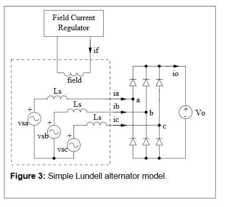

I woke up last night thinking about Lundell automobile alternators . They are three phase wye machines connected to full wave rectifiers.
there's the nonlinear load. It flattens the voltage peaks and that's certainly hatmonic-rich.
What happens at the simplest level is quadrature current cancels field mmf , presumably making stator flux non-sinusoidal
I've never seen a paper on harmonics in a Lundell but there must be one out there.

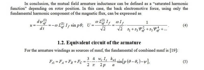

http://portal.unitbv.ro/Portals/0/UserFiles/User334/ICCS_2009_-_Stoia+Cernat+Mailat+Ilea.pdf
there has to be a painless way to teach it.
