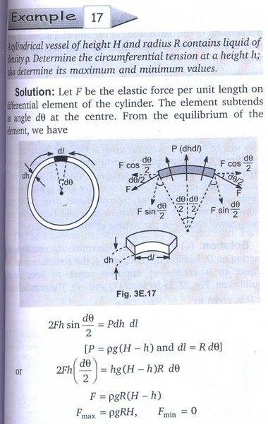

A cylindrical vessel of height ##H## and radius ##R## contains liquid of density ##\rho##. Determine the circumferential tension at a height ##h##; also determine its maximum and minimum values.
This is the scan of the original question(solved), I couldn't understand what was done here so I tried to solve it by myself and it has frustrated me so much that I am about to cry.
So my line of thought was that what would have been the case when there was no liquid filled inside it, would there still be any kind of circumferential tension. So, what I want to ask here is that is there any kind of manufacturing stress present in the cylinder due to its curved shape. This has me stuck for quite some time.
Also, I tried attempting the question as follows:-

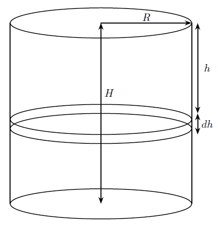

Consider a differential ring of height ##dh## situated a depth of ##h## as shown below:-
Now due to pressure of the liquid the force exerted on the walls of the differential element by water is given by
$$F_{\text{liq.}}=P(dh)(Rd\theta) \qquad \& \qquad P=\rho gh$$

$$2T\sin\left(\frac{d\theta}{2}\right)=P(dh)(Rd\theta)\\
\implies \require{cancel} T\cancel{d\theta}=P(dh)R\cancel{d\theta}\implies T=\rho Rg\;h\;dh$$
So, it seems that the circumferential tension depends on the differential height. That seems weird.
Also, doesn't the cylinder should have some thickness or else when it expands it will break immediately. Do correct me if my reasoning is wrong.

Cut the cylinder with a vertical plane through the cylinder axis .
What are the forces acting on one of the resulting half cylinders ?
What is the exact wording of the question?

I have included a scan of the original question and its solution (which I couldn't make head or tails of) in my original post.
I don't think that whoever thought up that question had much understanding of the relevant subject material themselves .
We are not even told whether the cylinder is open or closed ended . Open ended is a fictional problem with a relatively easy solution . Closed ended is a real problem with a more difficult solution .
The maths shown seems to apply to the fictional open ended problem .
I agree with Nidum. There is something very wrong with the problem statement and the solution that was presented.

The text is a little sloppy. First, the diagram shows "dh" as the thickness. One of the dashed lines is in the wrong place.
Next, the "Fh" term on the left is wrong. At first I thought it was supposed to be F(h), but now I think it should be Fdh. The author fixed that by making a compensating error, turning the dh on the right into h.
@decentfellow , your own mistake is related. Your T on the left should be TdhΔR.

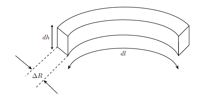

So that I am not confused can you tell me what is ##dh## and ##\Delta R##. And is there anyway I can change the title it was meant to be "Circumferential Tension(not tangent) in the cylinder."
In Fig 3E.17, there are three diagrams. The one at the bottom shows an arc of the cylinder wall. The length is dl.
dh is shown, but inconsistently. The arrows are vertical, indicating it is the height (vertical thickness) of the element. Since "dh" implies a small increase in h, that makes sense. But the two dashed lines show it as the thickness of the cylinder wall, which is wrong.
Since the cylinder radius is R, ΔR stands for the wall thickness.
Tension in the wall is like a negative pressure, so it is a force per unit area. If the tension is T then the force on the element is TΔRdh.

I drew a diagram which I think accurately tells the dimensions that you stated do tell if its correct or not.
For reference let's label it Fig.1
Also, I don't get how the tension is like a negative pressure is it due to the fact that the each layer along the thickness applies force on the one below, I can't seem to visualize how the force acts along the thickness.

Yes, that diagram is better. I used ΔR, not dR, because the d notation is reserved for infinitesimal changes, which will tend to zero in the limit. The thickness of the wall is presumed small, but not infinitesimal.
The use of the word tension in the question is inaccurate. What they mean is stress, specifically hoop stress. Tension is a force, whereas hoop stress is a force per unit area (just like pressure).
