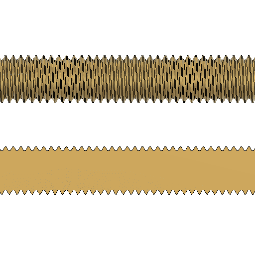

Hello, I have a power screw. According to the specifications, it is M8x1.25. Does that mean the effective diameter of the thread is 8 mm while the pitch is 1.25 mm? Is the screw radius just 4mm?
From the internet, it looks like the lead angle is atan(Lead/(pi*effective diameter of the thread)) or atan(number of threads*Pitch)/(pi*effective diameter of the thread).
Could you please let me know how to find the number of threads and the lead (m/rev)? What is the lead angle in this case? Thanks in advance.
To your first paragraph: yes and yes.
The "nominal diameter" would be 8mm. That's the outer edge of the helix.
The pitch would be 1.25mm. That's the distance from one turn to the next on the helix.
I am not sure what you mean by "lead angle". If it is the angle that helix would make with the surface being screwed, it would be atan(pitch/(pi*diameter)).
In the simple case, the "lead" as you describe it, would be the pitch - except that you would have to convert from mm/rev to m/rev.
In the less simple case, the screw may not actually penetrate at the full rate if the hole it is moving through has not been pre-drilled.

For your reference, here is a photo of the thread I have:
https://www.flickr.com/photos/149564621@N02/shares/9878y6
bbq_build said:
I think both refer to the same thing but please correct me if I am wrong.
Yes, they are the same. For the M8x1.25, there is only one helix.

That looks like a standard ISO thread .
https://en.wikipedia.org/wiki/ISO_metric_screw_thread
Thanks. Do I need to measure the thread angle to find out if it is ACME, Trapezoidal, Vee, Buttess, Round or square thread, etc? From the attached photo, can one tell what type it is? I got the power screw in Japan.
bbq_build said:
From the attached photo can one tell what type it is?
Yes . Almost certainly it is a 60 deg V thread .
Likes bbq_build
That's a CAD image of a screw with true ISO 60 deg V thread form . See the similarity to the thread form on your screw ?
Likes bbq_build
Nidum said:
That's a CAD image ofa screw with true ISO 60 deg V thread form . See the similarity to the thread form on your screw ?
They look quite similar but the one on top seem to have sharper crests and troughs. Do I have to concern about this?
