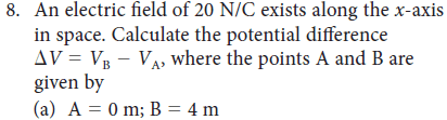

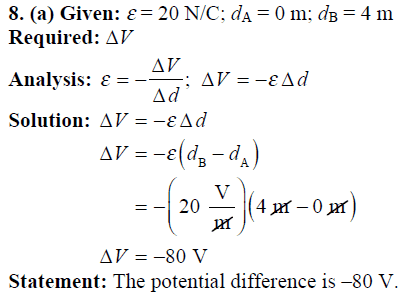

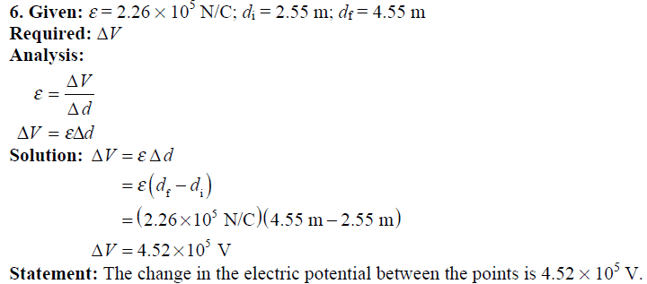

Here are two questions and I'm not sure how they are different.

For 6 they are ambiguous about the direction so you can assume any direction convention you like. May as well choose the one that makes it positive.
For 8 they are explicit about the direction so you just have to follow the math, which leads to a negative number in this case
In 8 the field points along the +ve x axis. Therefore, this is the direction of force on a positive particle. Since the force is in the direction of decreasing potential, E = -dV/dx, ie V falls, as x increases.
