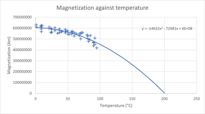

Summary:: Hello, I am doing a report for my IB course that requires some mathematics to be done. I have found this thread incredibly useful and I would like to reach out to ask for some clarification.

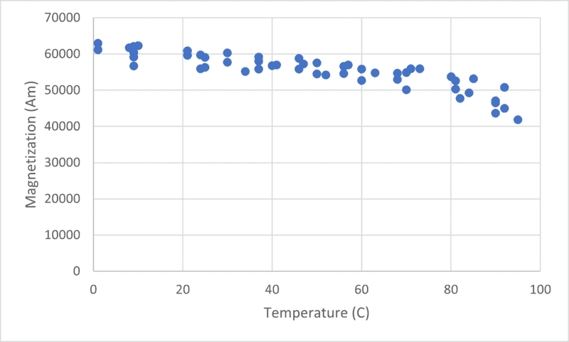

My experiment recorded the magnetic flux density directly above neodymium disc magnet, at different temperatures by submerging the magnet in water, the range of temperature is about 0-100 C. I plotted some diagrams in order to do analysis and here is where I ran into troubles, I am looking a theory or formula compare my results to, but most information I can find online are too complex. Here are the information I have collected and would like verification on.
Formula: M/M0 = ((Tc-T)/Tc)^γ
M = B(u0)
B = magnetic flux density (tesla/T)
M = magnetization (Am)
T = temperature (kelvin/K)
u0 = permeability of free space = 4π x 10-7
Remanence of neodymium ~ 1-1.3T
M0 = 1.3(u)
Tc = Curie Temperature = 320C = 593K
Please tell me if any of these definitions, formulas and constants are correct, I thank you in advance for your help.

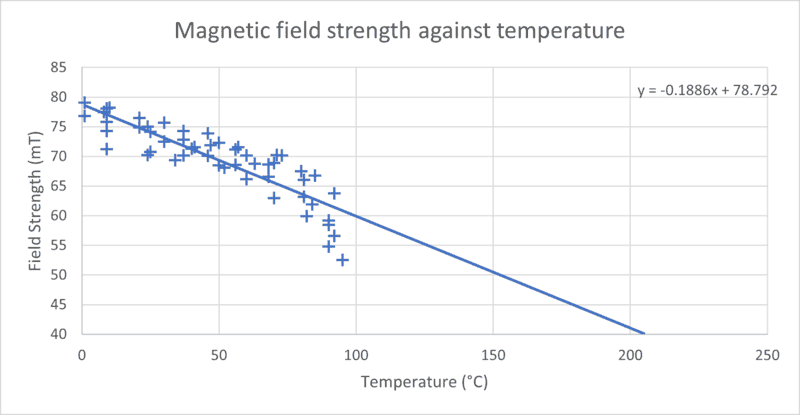

and with a closer look at the data, it appears your second set might have the decimal in the wrong place. ## mT ## is ## 10^{-3} T ##, and magnetization in A/m is ## B (in \, Tesla)/(4 \pi E-7) ##.
and I see you also don't have 1.0-1.3 T for the magnetic field strength at low temperature. How was the magnetic field measured? Was it with a sensor that was at some distance from what presumably is a cylindrical magnet? These extra details are needed to properly analyze the data.

You are on the right track. I agree with @Charles Link that your data look good considering that you used water to make your measurements. Here are my suggestions if you wish to do more with this.
1. Experimental
I understand that you had to stop at 100 °C because you used water up to its boiling point. The Curie temperature for a neodymium magnet is about 320 °C. Have you considered going higher than that with something other than water, e.g. cooking oil? If you do that, please be very careful and take good precautions because hot oil can give real nasty burns.
2. Data analysis
Forget the linear and polynomial fits in Excel. They only put solid lines near the data points but the fitted parameters are not very informative. You have a theory that says $$\frac{M}{M_0}=\left(\frac{T_C-T}{T_C}\right)^{\gamma}$$ Unless you have measurements all the up to ##T_C##, you can accept that TC = 320 °C and see if you can pluck the critical exponent ##\gamma## from the data.
Use Excel to make a plot of ##\ln\!\left(\frac{M}{M_0}\right)## vs. ##\ln\!\left(\frac{T_C-T}{T_C}\right)##. That should be a straight line with slope ##\gamma## which makes the graph much more informative.

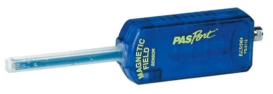

Thank you for the quick reply! I measured the magnetic field strength using a sensor from Pasco which was connected to a laptop for data collection:

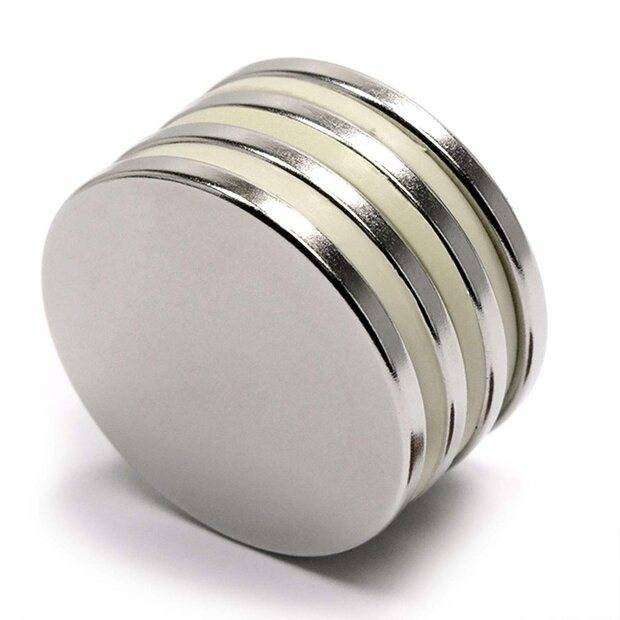

The magnets I used were circular, flat disc magnets:
I pointed the top of the sensor to the flat side of the magnets during measurements, the tip of the sensor was touching the magnet when measurements were taken.

@IBphysics For a permanent magnet, the ## M_o ## value depends on the shape of the magnet. The number 1.3 is for a long cylinder, (and for this case I believe the value of ## B ## at the surface is .65 T). It is somewhat difficult to do any accurate calculation for a flat disc shape, but from first principles using pole theory and surface current concepts, the ## M_o ## value will be much lower than 1.3, as you determined. [Edit: See post 13. The ## M_o ## value is somewhat lower, but the magnetic field ## B ## at the surface is much lower than even ## \mu_o M/2 ##].
For the analysis, you might try a curve fit as @kuruman suggested, using the known ## T_c ##, along with your experimental ## M_o ## of around ## M_o=80 ## E-3 T, and show that your data is consistent with this. You don't have data that takes you all the way to the Curie temperature, but that is ok. (Meanwhile, the data you have goes low enough in temperature, so that you can use an estimated value of 80 E-3 T for your curve fit. [Edit: See also post 8 below. You might find that your ## M_o ## is closer to 100 E-3 T]). [Edit: See post 13 for a correction to this].
and please check your decimal point on the second set of data, as mentioned in post 2 above.
It might be of some interest, if you have some extra time, to get a set of data using either a longer cylinder or a number of discs stacked together.(You should then get a measured ## B ## that is around .65 T at the surface). In any case, the data you already have is ok for a good analysis.

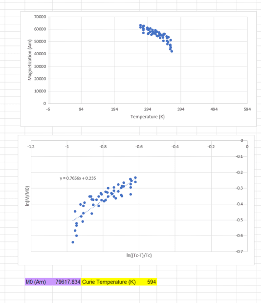

I have redid my math and I think I have the correct decimal places now.
Additionally, I would like to inquire if M0 is theoretically the measured B at absolute zero (0K / -273C)?
You previously mentioned using my experimental results of M0 = 80 E-3 T, wouldn't this be incorrect since my experimental data are in Celsius? Or am I confused about the definition of M0?
Additionally, is there a source for the 0.65T data? I previously planned to use M0 = (1.3)/(4*3.14*10^-7), it seems this is too optimistic of an estimation.
Attached is the new graph of Magnetization and Temperature in Celsius.

I tried different values for M0 from 1T to 0.08T (Maximum B measured during experiment at 274 K), the γ value measured by the log vs log graph seems too high at 0.7, should I change the curie temperature for this analysis?
Also, should I use absolute values for the log graph?
Looks like my preliminary assessment in post 8 might be accurate=the data does seem to trend downward before the Curie temperature. The best recommendation I have is that you might try getting a data set with a longer cylinder magnet. (The flat disc is really a poor geometry for trying to match theory with experiment for a couple of reasons. The magnetic field it has is much weaker than that of the longer cylinder, and with the weaker magnetic field, it may lose its permanent magnet nature somewhat below the Curie temperature.)
For the log-log graph, multiplying the numbers, (e.g. the magnetization), by a constant will not change the slope of the graph. You could try adjusting the Curie temperature=it is possible, as mentioned above, that the shape of the magnet (being a flat disc) is resulting in the magnet losing its permanent magnetism sooner than the Curie temperature=I'm going to have to try to google that to see what comes up. The literature does seem to be somewhat lacking on this topic.
