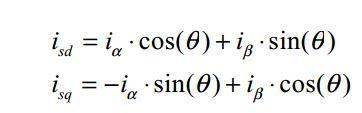

Hi everyone,
I am facing some problems in performing clarke-park transform for an induction motor(4 pole stator, squirrel cage IM).
The motor is run with three sine wave inputs, 120 degrees phase shifted with each other.
I am measuring the rotor position from the encoder and using twice of this value as theta for the park transform(position in radians). But since the rotor speed is slightly less than the synchronous speed, the transform is displaying a sinusoidal waveform. The frequency of Id-q sine wave increases with increase in the input frequency. For 10Hz input sine wave I am getting 0.01Hz sine Id-Iq values.
I also tried by integrating the speed(rad/s) to get theta, but the result was the same.
Instead of using the rotor position value, if I use a constant of 2*pi*f*t for theta, I get a proper constant dq values. But when I would be performing control, I won't have the frequency data available with me and it would be difficult to get a constant dq values.
I had used the same formulas for the PM synchronous motors and it gave constant Id, Iq values.
Could you please suggest any way of solving this problem.
You cannot measure the mechanical position (θ) in an asynchronous motor (induction motor) using clark-park, because the poles positions in the rotor will "slide", ( otherwise no currents will be induced in the squirrel cage ). The encoder will measure the mechanical position correctly. You can measure the mechanical position in a synchronus motor as the positions of the poles are mechanically fixed here.
Say you by a dc voltage-supply connects the phases of the induction motor, so that Ia and Ib = 1A, and that Ic = -2A: Nothing will happen when switching on the supply, because you will just induce a temporary opposite magnetic field in the rotor as to the stator-field. The motor will not turn/bounce. Now you turn off the supply and rotate the rotor by hand 90 electrical degrees. Turn on the supply again: Nothing will happen because you just induce the same magnetic field in the rotor again. The magnetic field cannot sense, that the rotor has been rotated mechanically 90 electrical degrees.
If you carry out the same with a synchronous motor, it will bounce ( at least one of the times).
So with an asynchronous motor and clark-park you can make a speed control with some accuracy.
Hesch has a point, rotor position is not the same as rotor field position because of slip.

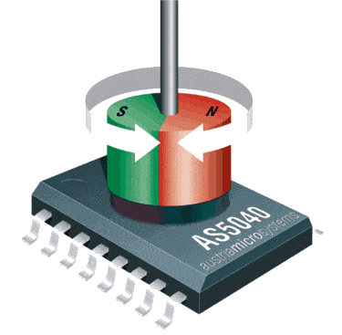

I don't know if use of clark-park is a must, but very cheap magnetic encoders are available:
A magnet, mounted at the shaft of the motor, rotates close to some chip that can sense the flux and can generate pulses and position. The advantage by this system is that the chip knows the position, even when power has just been turned on. A "normal encoder" (and its counter) must at first be "reset" at θ=0 before the counter-value represents a valid position.
I think? that the resolution of this magnetic encoder is about 1024 counts per rev. That is much better than what can be achieved by clark-park.
http://www.google.com/url?sa=t&rct=j&q=&esrc=s&source=web&cd=2&ved=0CCQQFjAB&url=http://ams.com/eng/content/download/1285/7214/AS5040_Datasheet_v2_01.pdf&ei=TFNCVY27KqvmyQPA-ICgDw&usg=AFQjCNEZv66SZXA_jDwQRnXIZVzhpcdzsg&bvm=bv.92189499,d.bGQ

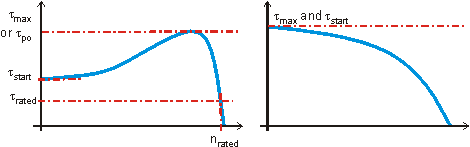

Here's a nuts & bolts explanation of how rotor resistance affects that curve
http://people.ucalgary.ca/~aknigh/electrical_machines/induction/design/rotor_influence.html
low r gives left curve, B motors for general use
high r gives right curve, D motors for constant torque loads like cranes or elevators.
