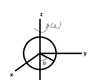

Consider the bead threaded on a cicular hoop of example 7.6 (pg 260), working in a frame that rotates with the hoop. find the equation of motion of the bead, and check that your result agrees with eq 7. 69. Using a free body diagram explain the result 7.71 for equilibrium positions
d2θ/dt2 = (ω2cosθ - g/R)sinθ 7.69
θo = ±arccos(g/ω2R) 7.72
In the inertial frame there is going to be a centrifugal force coriolus force and force of gravity
Feff = Fg + Fcf + Fcor
by the diagram
Fcf = mRω2sinθ Not sure about the direction
( I'm thinking it wouldn't really be in the r hat direction. more like Rcosθ. sounds redundant but I'm not sure how to explain it.)
Fcor = -2mvΩcosθ because it is in the southern hemisphere so it would deflect left which would oppose the gravitational force
I assume Feff = mR2[d2θ/dt2]
I can solve this problem by lagrange method, but I'm not fully understanding this non-inertial ref frame.
Suprisingly enough i actually did it right
Feff is mR(d2θ/dt2) = mRΩ2sinθ(rho_hat) -mgRsinθ
where rho_hat is cosθ
Deduced this by saying r' = r therefore R has to equal zero, but capital R is not the same as the radius in the equation above
