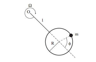

Around vertical axis ##O## a body on picture below (see attachment) is being rotated with constant angular velocity ##\Omega ##. On the circle we have a body with mass ##m##, that can feels no friction. Find position of that body as function of ##\phi ## and time. Calculate the energy of the system. Is it constant? Also find equilibrium position and frequency for small movements around equilibrium position.
Here is how I started, hopefully not completely wrong.
Firstly, one inertial coordinate system with origin in axis ##0## and axis ##\hat{i} ## pointing to the right and axis ##\hat{j} ## pointed up. Second, non-inertial system positioned in center of circle with radius ##R## where one axis is parallel to the line ##l## and the other of course perpendicular the ##l##.
I used notation ##^{'}## for all coordinates in non-inertial system.
Now ##m{\ddot{r}}'=a_{rel}+2\vec{\Omega }\times v_{rel}+\vec{\Omega }\times(\vec{\Omega }\times {r}')=\vec{F_r}+\vec{F_g}##
where:
##{r}'=R(cos\phi ,sin\phi )##
##\dot{{r}'}=v_{rel}=R\dot{\phi }(-sin\phi ,cos\phi )##
##\ddot{{r}'}=R\ddot{\phi }(-sin\phi ,cos\phi )+R\dot{\phi }(-cos\phi ,-sin\phi )##
##\vec{\Omega }=(0,0,\Omega )##
Now ##2\vec{\Omega }\times v_{rel}=-2\Omega R\dot{\phi}(cos\phi ,sin\phi )## and ##\vec{\Omega }\times(\vec{\Omega }\times {r}')=-\Omega ^2R(cos\phi ,sin\phi )##.
Also ##\vec{F_r}##, which is force on body in radial direction is than ##\vec{F_r}=F_r(cos\phi ,sin\phi )##. Now ##\vec{F_g}=F_g\hat{j}=F_g(sin\Omega t \hat{{i}'}+cos\Omega t \hat{{j}'})=F_g(sin\Omega t ,cos\Omega t )##.
Now writing everything in each directions should give me:
##\hat{{i}'}##: ##-R\ddot{\phi }sin\phi -R\dot{\phi }cos\phi-2\Omega R\dot{\phi }cos\phi -\Omega ^2Rcos\phi =F_rcos\phi +F_Gsin\Omega t## and
##\hat{{j}'}##: ##R\ddot{\phi }cos\phi -R\dot{\phi }sin\phi-2\Omega R\dot{\phi }sin\phi -\Omega ^2Rsin\phi =F_rsin\phi +F_Gcos\Omega t##
That is IF I am not completely mistaken. Before I continue: So, my question here is: Is everything ok so far? Is this the right way to solve the problem OR are there easier ways? Maybe using Lagrangian mechanics or...? Thanks in advance.

I agree, but how would I write the distance of mass from the axis in this case?
Because ##L=T-V##, and ##T=\frac{1}{2}m\dot{\vec{r}}^2## where ##\vec{r}## is a vector from ##O## directly to the body with mass ##m##. The vector's size is not constant also it's direction changes.
Since the Lagrangian approach can only be used in inertial systems, I would assume that this should work:
Let's use ##r## for distance between the mass and ##O##. Than ##r=l+R+Rcos\phi =l+R(1+cos\phi )##.
Now in inertial system this should like something like ##\vec{r}=(l+R(1+cos\phi ))(cos\Omega t, sin\Omega t)## if ##\Omega t## is measured counter clockwise direction with ##0## when ##\vec{r}## is parallel to ##\hat{i}##.
Is this what you imagined?
However, the first method, using vectors, if I continue where I stopped:
If I multiply the first one with ##-sin\phi ## and the second one with ##cos\phi ## than sum them together, I get a rather nice equation:
##\ddot{\phi }=\frac{F_g}{R}cos(\phi +\Omega t)## where I can see that units don't match because I completely forgot about ##m##, therefore:
##\ddot{\phi }=\frac{F_g}{mR}cos(\phi +\Omega t)##

I seriously think that we complicated this way to much... Firstly, I can see no reason why even bother with potential energy when axis is perpendicular to the circle plane.
Here is my solution, for 2D motion and hopefully it is the right one.
##L=T-V##
##T=\frac{1}{2}mv^2## where ##\vec{v}=v_{rel}+\Omega \times \vec{r}^{'}+\Omega \times \vec{R_k}## where ##\vec{R_k}## is a vector from the origin of coordinate system in the center of the circle to the axis, where fixed coordinate system is.
Now ##\vec{r}^{'}=(Rcos\phi ,Rsin\phi )## and ##\Omega =(0,0, \Omega)## and ##\vec{R_k}=(l+R,0,0)## all expressed in system with the origin in the center of the circle.
Everything together gives me ##\vec{v}=(-Rsin\phi(\dot{\phi}+\Omega),Rcos\phi (\dot{\phi}+\Omega)+l+R)## and accordingly
##T=\frac{1}{2}m[R^2(\dot{\phi}+\Omega)^2+\Omega ^2(l+R)^2+2R\Omega cos\phi(\dot{\phi}+\Omega)(l+R)]##
and ##V=0##.
Now Euler-Lagrangian equations leave me with
##\ddot{\phi }+\frac{l+R}{R}\Omega ^2sin\phi =0##
Therefore equilibrium position at ##\phi _0=0## and ##\phi _0=\pi ## for unstable position.
Since now we know that ##\phi ## is small around equilibrium position, let's use Taylor expansion and write
##\ddot{\phi }+\frac{l+R}{R}\Omega ^2\phi =0##
From where ##\omega =\Omega \sqrt{1+l/R}##I mean, don't get mad at me but it says axis is VERTICAL and... yeah.
