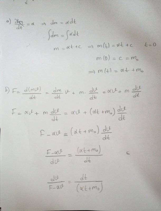

A truck with empty mass m0 starts to move under a constant force F0 in a rainy weather. Assuming that the rate of change of the mass of the truck starts to move from rest. a) Find the mass m(t) of the truck, b)Find the speed v(t) of the truck, c)find the distance taken x(t) by the truck; all at time t..
F=m*dv/dt
P=(dm/dt)*v +m*(dv/dt)
Please help please

yes thanks for warning. However the site does not allow me to edit the homework equations.There was also a mistake in the question. I am reposting here:
  • A truck with empty mass m0 starts to move from rest under a constant force F0 in a rainy weather. Rain fills the back of the truck. Assuming that the rate of change of the mass of the truck is a constant α.
all at time t..
Homework Equations:
F = dP/dt = d(mv)/dt = (dm/dt)*v +m*(dv/dt)

How far can you get without any help?
I think I solved it. Can you check please?
Post your answers if you want.

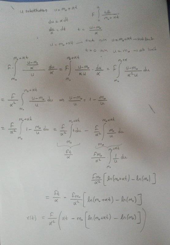

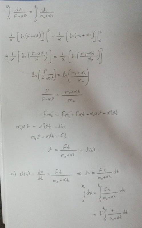

of course thank you Iwas preparing my answer right now:

I think I solved the problem can anyone please check it?
Looks good to me. There was a much quicker way to do part b), by integrating the momentum.
For part c) you could expand the log function using Taylor series and check what you have makes sense. Especially if ##\alpha = 0##.
Note that the log function can be simplified to something of the form ##\ln(1 + \alpha t/m_0)##.
Good work!
Good work!
Thank you so much mister PeroK! now that at least my solution is approved, I can give this solution to my teacher without concern! thank you!
I think you meant, by integrating the force to get the momentum.
