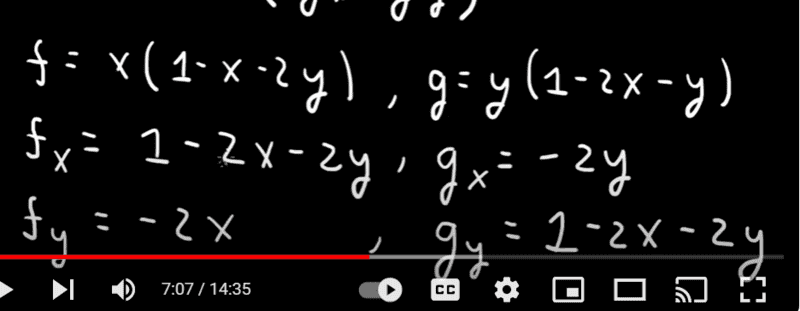

Also, you might find this video useful as it walks you through a similar-ish problem.
Thanks; hopefully this gets it and I can move to the Jacobian Maitrix?
Herem from the video I am unclear about the process, are the functions f and g being integrated to their original form and the differentiated to find the partial derivatives?

I did look at the video; he seems to be approaching the Jacobian maitrix differently from my tutor.

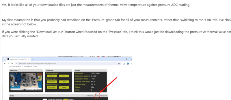

Its just so frustratting and unneccsary.
Just an ancilliary, mt lab partner (an English Teacher) and I did a 90 hour experiment following explicitly the instructions given.
We downloaded the data and inspected the files without finding the required data
My lab partner contacted his tutor, mine is reticent in replying and the data was downloadable on the TITR tab but we weren't told this.
I contacted my tutor but have not had a reply.
Knowing what we need to know my partner and I can redo the experiment if the System allows.
