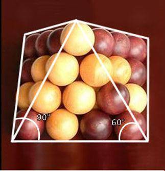

I took a different approach on this and compared the packing density of equal-sized congruent spheres within a regular tetrahedral container (four similar equilateral triangular faces) vs. a square pyramidal container (four similar equilateral triangular faces with a square base), as shown below:
(Figure 1)
(Figure 2)

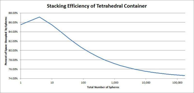

I found that, with a very large number of spheres (>100,000), the "packing efficiency" of spheres (volume of spheres/volume of container) within a regular tetrahedral container approached ≈74.048% ("Hales' density" or ∏/√18 ), whereas the packing efficiency of spheres within a square pyramidal container approached only ≈60.460%.
Oddly enough, the space-efficiency of a tetrahedral ball stack decreases in proportion to the number of balls it contains, whereas the space-efficiency of a pyramidal ball stack increases with the number of balls, as shown below:
(Figure 3)
(Figure 4)

The packing efficiency of a regular tetrahedral container decreases with the number of spheres until it reaches a limit of ≈74.048% (Figure 3). Note that the packing efficiency actually increases between 1 sphere to 4 spheres. This is unexpected, and could be an error in my calculations, or it could be accurate. I've checked it numerous times. Feel free to check it for yourself.

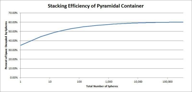

The packing efficiency of a square pyramidal container increases with the number of spheres until it reaches a limit of ≈60.460% (Figure 4).

Clearly, if the number of balls doesn't exactly fill a level, it will be less efficient to package.
It depends on what you mean by "exactly." All the balls in both stacks are touching all the adjacent balls. It's the size of the interstitial spaces that makes the difference.

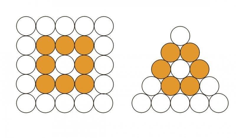

I was trying to eliminate the square pyramidal arrangement as an efficient way of packing spheres. In one of the other forums, someone had said it was the same as a regular tetrahedral arrangement. I had to demonstrate, to myself at least, that it was not.
You can see that interstitial spaces in the "plan" of the square pyramid base (1st figure) are larger than those in the tetrahedron base (2nd figure). I also stacked some golf balls to hopefully give a real-world of demonstration of what I'm trying to do here (3rd and 4th figures). When a very large number of balls is used, the density of the pyramidal arrangement is ~0.6046, whereas the density of the tetrahedral arrangement is ~0.7048. I've shown this in the calculations listed in my initial post.
Perhaps Thomas Hales used the square pyramidal arrangement in his proof of the Kepler Conjecture (i.e., that this was NOT the most efficient, or densest, way of stacking equal-sized congruent spheres).
It may not be rocket science, but if you can't have fun solving geometric puzzles, what's the point?
fizixfan said:
...whereas the density of the tetrahedral arrangement is ~0.7048. I've shown this in the calculations listed in my initial post.
~0.7048 is incorrect. I meant ~0.74048.
These are indeed the same structures, just oriented (and therefore terminated) differently.
Try to remove the 5 balls along the edge of the tetrahedral pyramid. You will see squares of 4 ball touching each other in a square arrangement, just as in the base of your square base pyramid.
The stacking is known as face-centered cubic (FCC) and occurs in many common metals such as copper.
I tried removing the 5 balls along the edge of the tetrahedral pyramid, but I still did not see 4 balls touching each other in a square arrangement.
In the illustration above, the balls in the square arrangement are show in the first figure. Notice that the ball in the center is touching eight other balls. In the second figure, the base layer of the tetrahedral arrangement, the center ball is touching only six other balls, making it denser. Not to complicate things too much, but the second figure is also a cross-sectional view (looking horizontally at the stack) of both the square pyramid and the tetrahedron. But it's the way the balls are arranged in each horizontal layer of the stack that makes the difference in the density.

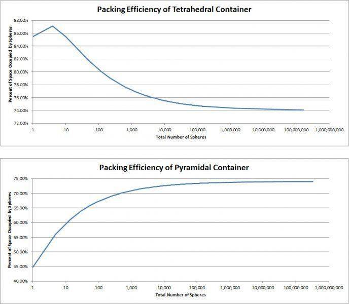

I found this to be true, but only with very large numbers of spheres (>10,000). The density of the tetrahedral arrangement decreases with each successive layer of spheres, while the pyramidal arrangement increases as more layers of spheres are added, until they approach convergence at ~20,000 spheres.. Here are two graphs illustrating this:
