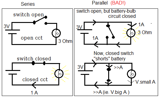

As someone who has used these terms since time immemorial (well nearly) I would say, as BvU, they come from DC circuitry. I just amplify his description a little.
Open circuit means no current can flow. There is no continuous path round the circuit.
Closed circuit is the opposite: there is a continuous path, via whatever wires and components, and current can flow. The amount of current depends on the voltage sources in the circuit and the total resistance of the circuit.
The simple example is the battery, switch, lightbulb connected with copper wires in a series circuit. When the switch is open, you have an open circuit; when the switch is closed you have a closed circuit.
A short circuit is a bit of a misnomer, because it does not apply to a complete circuit. A short circuit between two points simply means that there is a very low (ideally zero) resistance path between those two points.
That could apply to any bit of wire joining two components of course, but that would not be at all unusual or worthy of comment. We use the term short circuit usually, when that bit of wire (or equivalent) is somewhere unusual.
In the above series cct, we would not usually talk of the switch shorting the battery and bulb together when it is closed, even though that is exactly what it does.
But in a parallel circuit, so that the bulb was on when the switch was open circuit, then when we close the switch the bulb goes out because the switch shorts, or short circuits, the battery (and for that matter the bulb.)
We do not usually switch a bulb off by providing a good conductor in parallel to let the current flow unrestricted from one end of the battery to the other. I can't tell you how much the current is here: it depends on the very low resistance of the wires, switch and battery. If they truly were zero, then the current would be infinite - which is not possible. Through the bulb there is still a very small current, because the wires and switch are not zero resistance.
If, in the series cct a piece of uninsulated wire happened to fall across the battery terminals, that would do the same job as the parallel switch and short (cct) the battery.
