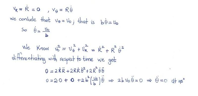

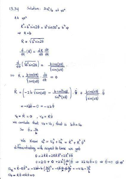

13.34 The curved portion of the cloverleaf highway interchange is defined by
##R^2=b^2sin2θ##, 0<=θ<=90deg. If a car travels along the curve at the constant speed v0,
determine its acceleration at A
[/B]
Is this wrong?
Check your expression for ##\ddot{R}##. There should be a ##\ddot{\theta}## in it.​
and also you're missing a ##\dot \theta^2##.

Is the following correct:
Marc Rindermann said:
and also you're missing a ˙θ2θ˙2\dot \theta^2
I cannot see where I am missing the ##\dot θ^2##

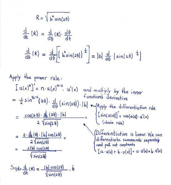

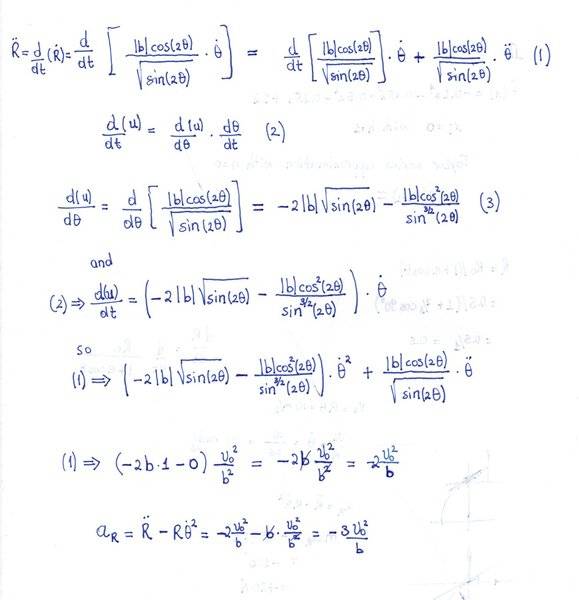

first of all you can check whether your equations are correct if you do a dimensional analysis.
Look at ##\ddot R = 2b\dot\theta##
##[\ddot R] = ms^{-2}##
##[2b\dot\theta] = ms^{-1}##
So you see something is not quite right.
When you take the 2nd derivative of ##\dot R = b\cos(2\theta)(\sin(2\theta))^{-1/2}\dot\theta## you need to remember that the derivative of both ##\cos(2\theta)## and ##(\sin(2\theta))^{-1/2}## produces another ##\dot\theta##.
Can you check this?
