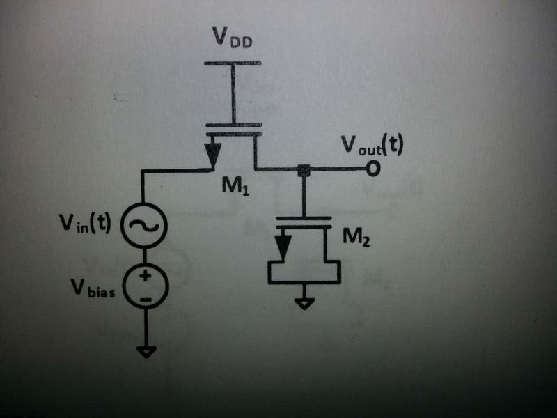

In summary, M1 is triode region b/c the drain and drain source voltage is 0 which will always be less than the output voltage. However, I am having troubles finding M2's region of operation, VDS >= VGS - VTH. Vout - Vbias >= Vdd - Vbias - VTH
tsaitea
In the attached photo, I found M2 to be triode region b/c the drain and drain source voltage is 0 which will always be less than the output voltage.
However, I am have troubles finding M1's region of operation, VDS >= VGS - VTH.
Vout - Vbias >= Vdd - Vbias - VTH **Vbias = 0.8 V , VTH = 0.5 V.
Vout >= Vdd - VTH
Im at this point now b/c Vout may vary.
For the moment assume Vin(t) = 0.
For the Fet to be on the gate voltage must be more than Vth below the source. In other words Vbias > Vdd+Vth.
You have not stated your problem.
M2 has no effect whatsoever on the output voltage unless the gate breakdown voltages are exceeded.
So assuming Vin = 0, for the FET to be on VGS > VTH.
Where VG = VDD and VS = Vbias therefore,
VDD - Vbias > VTH
Vbias < VDD-VTH
I don't quite see where you got Vbias > Vdd + Vth from :confused:
Right so for M2 Vout > Vth ,
For triode,
VDS2 < VGS2 - Vth
0 < Vout - Vth and since Vout > Vth,
M2 will be in triode.
VDD - Vbias > VTH
Vbias < VDD-VTH
M1 is a P type FET. So if I remember correctly the gate (VDD) has to be below the drain/source for it to be ON. Therefore Vbias must be > Gate + Vth.
M2 appears to be configured as a capacitor.
CWatters said:
M1 is a P type FET.
I don't think so. It's an N type.
The more conventional symbol for an N type is an arrow pointing into the substrate, but the alternative symbol is the source pointing away from the device, with no subtrate indicated.
Darn it you are right. I should have looked more carefully.
Well, without actual values for the bias and ac inputs the whole business is unsolvable anyway ...
