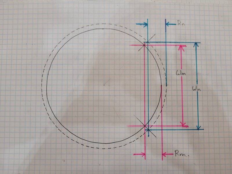

So here is where I am so far. The Beta angle is not that important, what I really need is the Radius of the Tangential Arc (Re)
I hope what I have so far makes sense, and that I'm going in the right direction.
The nominal dia. is N, and the minor dia. is M
Solve for Rn
$$\alpha = \arccos(1 - 2(R_n / N))$$
Solve for Wn
$$R_n = \frac{N - \sqrt{N^2 - {W_n}^2}}2$$
Solve for Rm
$$\alpha = \arccos(1 - 2(R_m / M))$$
Solve for Wm
$$R_m = \frac{M - \sqrt{M^2 - {W_m}^2}}2$$
Radius of Tangential Arc (Re)
$$R_e = \frac{({W_m}/2)^2 + ({W_n}/2)^2} {W_n}$$
I've tried isolating the R and W variables but solving for R and W is beyond my comprehension. It's been a couple of decades since I have last done anything of this complexity in school.

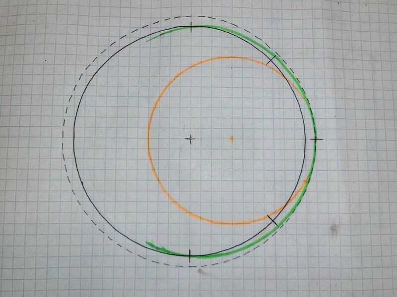

Im still struggling to find the correct calculation for the Radius of the Tangential Arc (Re)
According to the Kennametal Catalog:
$$R_e=\frac{(\frac{M}{2})^2+(\frac{N}{2})^2}{N}$$
Which works if the alpha angle is 90 degrees, but stays constant even if the alpha angle is reduced to 45 degrees.
When I tried it as a ratio of the alpha angle divided by 360, it still works when the alpha angle is 90 degrees.
When I change the alpha angle to 45 degrees, the Tangential Radius ends up being less than my tool radius which is incorrect.
$$R_e = \frac{(({M}^2*({\frac{\alpha}{360}})) + (({N}^2*({\frac{\alpha}{360}}))} {N}$$
When I tried it as a ratio between the Minor Diameter and and Nominal Diameter chordal lengths, it still works when the alpha angle is 90 degrees. When I change the alpha angle to 45 degrees, the Tangential Radius still ends up being less than my tool radius which is still incorrect.
$$R_e = \frac{(\frac{W_m}{2})^2 + (\frac{W_n}{2})^2} {W_n}$$
$$W = \text{Diameter} * \sin\alpha$$
$$R_e = \frac{(\frac{M * \sin\alpha}{2})^2 + (\frac{N * \sin\alpha}{2})^2} {N * \sin\alpha}$$
I'm all out of ideas.
I've attached another drawing to help with my explanation.
The green arc is the Radius of the Tangential Arc with an alpha angle of 90 degrees.
The orange circle is the diameter of the cutting tool.
As you can see, an alpha angle of 45 degrees should have a Tangential Radius larger than the radius of the cutting tool.
