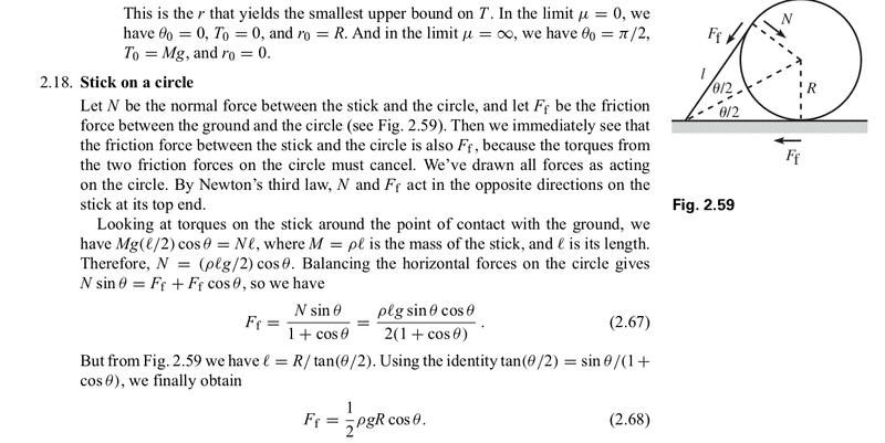

Using the results from problem 2.18 for the setup shown in the Figure below show that if the system is to remain at rest, then the coefficient of friction:a) between the stick and the ground must satisfy
μ ≥ \frac {sin(Θ)cos(Θ)} {(1+cos(Θ))(2-cos(Θ))}
The result from 2.18 is:
F_f = \frac 1 2 ρgRcos(Θ)
Which is the friction between the stick and the circle.
The sum of torques on the stick is (my origin is the point where the stick and circle is touching):
## \frac L 2 mgcos(Θ) + L F_fsin(Θ) = L Ncos(Θ) ##
This is how far I am.

ρ is the mass density of the stick. ##F_f## is the friction force. The complete solution of 2.18 is below:

That helps, and I can see that the frictional force from ground on stick must also be Ff.
What about N? Is there some simple argument that the two normal forces on the stick are the same?
What other equations do you have for forces on the stick?

Okay, well this is the part I am having trouble with, but here are the sum of forces on the stick in the horizontal tradition. I have chosen a traditional axis where the positive x is pointing from the point of contact between the stick and ground and toward the circle:
Σ F_x = F_f + N_gsin(\theta) - N_csin(\theta) - F_{f,c}cos(\theta) - F_gsin(\theta)
where ##N_c## is the normal force between the circle and ground. ##F_{f,c}## is the friction force between the circle and the stick

Consider horizontal forces on the stick+circle system.
Okay I understand now. The only horizontal forces on the stick+circle system is the friction forces... Is my horizontal forces on the stick correct:

How does the normal force from the ground have a horizontal component?
Since we have established all three frictional forces are equal, no need to distinguish them with different subscripts.

Right, but your equation was supposed to be for horizontal forces on the stick, not forces along the stick.
Okay, now I understand. The normal force from the ground does not have a horizontal component because the force is acting on the stick in only one direction and that is the vertical direction.
Here is my revised equation for horizontal forces on the stick:
Σ F_x = F_f - N_csin(\theta) - F_fcos(\theta)
Check the signs. Which way does the friction from the cylinder act on the stick?
