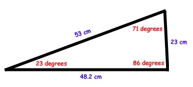

We have an investigative project and our group's topic is inclined plane surfaces. I need help in getting the coefficient of friction of the toy car. We will investigate the coefficient of friction of different surfaces. Our teacher didn't (and will never) discuss to us this topic. PLEASE HELP!
Speed of the toy car = 3s

Since you have a distance and a time I'd go for a kinematics equation, for that you'll need to find an expression for the net acceleration of the car along the ramp

To find acceleration use Newton's second law, what forces act on the car?

Well the frictional force is what you're trying to find so it will just have to be assigned some character [itex]F_{friction}[/itex], now the other force you want to consider is gravity, can you get the component of gravity along the ramp?
friction force is always to the opposite of motion
we have two component of gravity : gmsinx ... gmcosx
&the normal force :normal to the surface
Then we can use Newton's laws to estimate F(friction)

Do you know about the relation Ffriction = μN ??
Can you draw all the forces acting on the toy car when placed on a ramp?
A good textbook should help here.
However if you don't have one you will need to draw a force diagram and write an equation weight of the car down the slope. In a static case where the car is not sliding or rolling the weight down the slope will equal the friction force up the slope. You should be able to rearrnage and find what you need.
