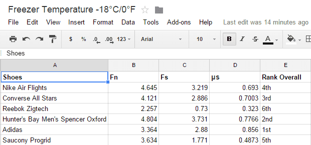

I know what friction is and how to get the coefficient of friction. The science fair I'm doing is basically two labs but the overall question is "How does different temperatures affect the coefficient of friction in shoe brands?"
Need help understanding how friction in shoe soles worn and how different shoe soles effect different coefficients of friction. This is for science fair. I have the experiment and results I just don't know why I got the results I did.
My experiment. If the results are needed someone can tell me.

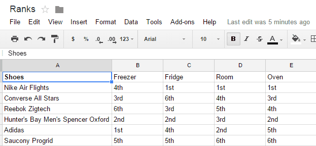

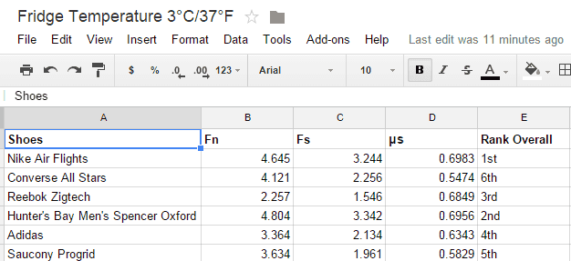

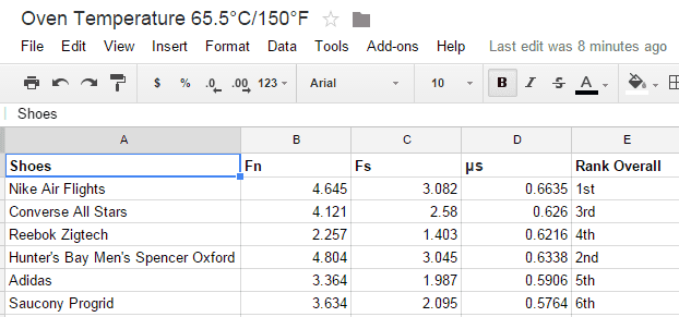

Here is my research paper and results. Best I was able to do was screenshot the data. Thanks for the help so far and future help you are giving. If you have any questions that would help you help me just ask. And what do you think of this project? I am in 8th grade by the way so how is it for an 8th grade project. And if you need pictures of the shoes I can send those too!

This is my freezer results:
Shoes;Fn;Fs;μs;Rank Overall
Nike Air Flights;4.645;3.219;0.693;4th
Converse All Stars;4.121;2.886;0.7003;3rd
Reebok Zigtech;2.257;0.73;0.323;6th
Hunter's Bay Men's Spencer Oxford;4.804;3.731;0.7766;2nd
Adidas;3.364;2.88;0.856;1st
Saucony Progrid;3.634;1.771;0.4873;5th
This is my fridge results:
Nike Air Flights;4.645;3.525;0.7588;1st
Converse All Stars;4.121;2.824;0.6852;4th
Reebok Zigtech;2.257;1.483;0.657;5th
Hunter's Bay Men's Spencer Oxford;4.804;3.327;0.6925;3rd
Adidas,3.364;2.443;0.7262;2nd
Saucony Progrid;3.634;2.432;0.6692;6th

This is my oven results:
Nike Air Flights;4.645;3.082;0.6635;1st
Converse All Stars;4.121;2.58;0.626;3rd
Reebok Zigtech;2.257;1.403;0.6216;4th
Hunter's Bay Men's Spencer Oxford;4.804;3.045;0.6338;2nd
Adidas;3.364;1.987;0.5906;5th
Saucony Progrid;3.634;2.095;0.5764;6th
This is my overall results:
Shoes;Freezer;Fridge;Room;Oven
Nike Air Flights;4th;1st;1st;1st
Converse All Stars;3rd;6th;4th;3rd
Reebok Zigtech;6th;3rd;5th;4th
Hunter's Bay Men's Spencer Oxford;2nd;2nd;3rd;2nd
Adidas;1st;4th;2nd;5th
Saucony Progrid;5th;5th;6th;6th

Yes, that works (but what are the upper two temperatures? Maybe that's in the PDF - no matter).
You might have a problem with the freezer case. The results are so scattered I wonder if ambient conditions are distorting the results. When you take the shoes out of the freezer, what might happen that could greatly affect friction, and how might this vary from day to day?
I honestly have no idea why the results are so different I tested them in the same freezer and at the same location but I had to open the freezer to grab a shoe and then shut it so I wonder if a few seconds of the door opening drastically altered the temperature that quickly that it would throw off the results
I'm not thinking of temperature variation. What would happen if you took reading glasses out of a freezer and put them on?

So do you think perhaps a thin layer of ice, or at least moisture, might form on the soles? And do you think this might vary according to conditions in the room, or on the test ramp etc?
