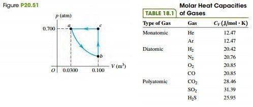

The pV-diagram in Fig. P20.51 (See attached file) shows the cycle for a refrigerator operating on 0.850 mol of H2. Assume that the gas can be treated as ideal. Process ab is isothermal. Find the coefficient of performance of this refrigerator.
K = QC/|QH - QC|
pV = nRT
Cp = Cv + R
Isothermal expansion: Q = W = ∫p dV = nRT*ln(V2/V1)
Constant volume: Q = nCvΔT
Constant pressure: Q = nCpΔT
QC = Qa-b + Qb-c = nRTa * ln(Vb/Va) + nCv(Tc - Tb) = paVa * ln(Vb/Va) + VbCv(pc - paVa/Vb)
QH = Qc-a = n(Cv + R)(Ta - Tc) = pc(Cv + R)(Va - Vc)/R
My answer K = QC/|QH - QC| = 0.462
Correct answer K = 6.23
What did I do wrong?
Did you leave out R somewhere in the last term on the right side?
Does this give a postive or negative value for QH? In the formula K = QC/|QH - QC|, is QH considered as positive or negative?
Likes Elias Waranoi
QC = paVa * ln(Vb/Va) + VbCv(pc - paVa/Vb)/R
QH is heat the leaves the working substance so it should be negative. Apparently K = |QC|/( |QH| - |QC| ), thanks for the help I got the correct answer now.
