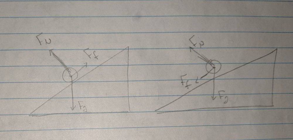

On the banking road, if there was no friction it would start moving outwards, towards the outer ends of the circle since there is no force pushing against it's motion. Since the car is not moving outwards, it is static in that direction.
So, the friction has to do with the centripital force for banked turns. The coefficient of static friction applies since the banked turn is to keep the vehicle from changing it's radius while in the turn. It is static in the radial direction.

Maybe that photo makes it more clear?
It has to do with the direction of the centripetal acceleration, but along the surface of the banked turn.

As I wrote in post #2, sliding is relative motion of surfaces in contact. In rolling motion, the point where the wheel contacts the other surface is instantaneously stationary relative to that surface.

Friction is either static or kinetic. It cannot be static in one direction and kinetic in another. That is why it is dangerous to brake hard while taking a corner - the combination of the braking force vector (in the direction of travel) and the (lateral) cornering force exceeds the maximum static frictional force; skidding begins, and the kinetic frictional force is directly opposed to the relative velocity of tyre on road, so has little or no radial component.

It might help to plug in some variables.
Suppose you are turning a corner radius r at steady speed v on a level surface. The acceleration you need is centripetal, v2/r. Suppose the coefficient of static friction is sufficient to handle this, i.e. is at least v2/(rg).
You now apply the brake to the extent that, if going straight, you would achieve acceleration a (negative) in the direction of velocity. If still no skidding, the frictional force on the tyres needs to be mv2/r laterally (i.e. normal to the velocity) and ma parallel to the velocity. If the net force, ##m\sqrt{a^2+\frac{v^4}{r^2}}## exceeds ##\mu mg## you will skid (and the wheels are likely to lock).
So now you have kinetic friction, and that acts opposite to the direction of relative motion of the surfaces. If the wheels have locked then that means opposite to the velocity of the vehicle. There's a bit of moderation in direction at individual wheels since the vehicle is still rotating, but that cancels out for the car as a whole. So the kinetic frictional force does decelerate the car, but there is no longer a lateral component, so you travel in a straight line.
