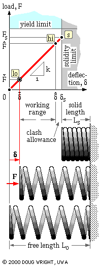

Hello I have a question on coil-over preload for Progressive springs. I understand the theory on spring rates, in that setting pre-load does not alter spring rate (Hookes Law), it just compresses the spring, adding load, which does raise the height of the car. Setting pre-load is necessary so to load the spring slightly so as to not allow it to flop or rattle when fully extended (if you know what I mean). Conversely, setting too much pre-load has its problems such as reduced spring and damper travel.
Thats all well and good for a linear spring, BUT what about a progressive spring? As you know a progressive spring is just that...the rate is lower at the bottom for normal driving, and progressively the rate increase as the spring is compressed, well I think that's how it works!
My question is...by setting more pre-load, despite popular belief, would this be altering (increasing) spring rate?
