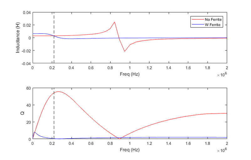

I have an image I can share, but don't know how (the image icon wants a URL, so I can't navigate to my folder to get image)...It shows the Ls-Q of the inductor with and without the ferrite...the self resonance of the coils is around 840kHz.

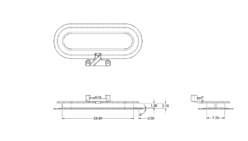

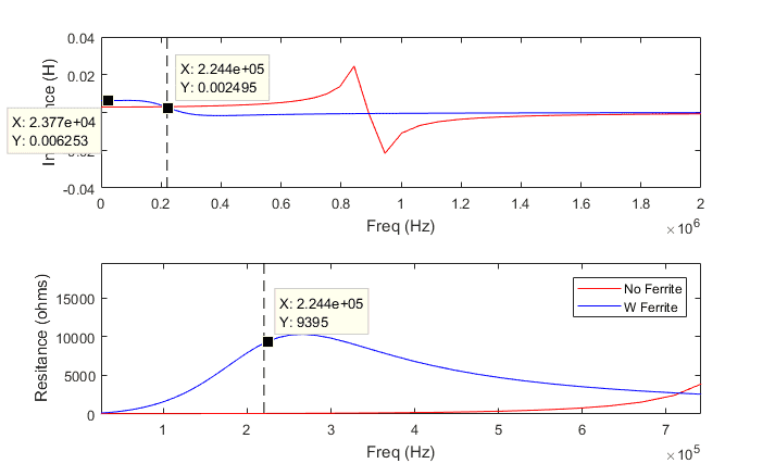

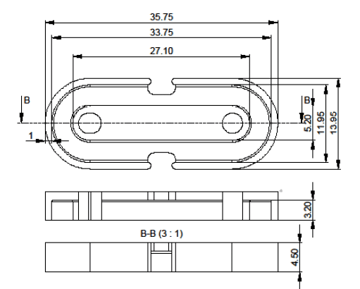

Here are two of the plots I generated with data from the LRC meter, same coil, with and without the ferrite. (Ls-Rs, Ls-Q). I'm also including the coil and the ferrite for reference...

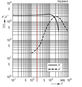

I think the issue is with the material of the core. I did a quick calculation for the Resr using the following relation: $$\frac{u''}{u'}=\frac{Resr}{2*\pi*f*L}$$ using data from the MN60 ferrite material datasheet, u''=1800, u'=6000, f=200kHz, and the corresponding L as shown in the Ls-Rs plot @ 200kHz (previous post), and got around 1.4kohms which is in the same order of magnitude as what the LRC is meausring.
I then used the data from an N48 ferrite material: u''=35, u'=2500, and the Resr is around 68ohms which is reasonable. Next step is to see if I can have someone fabricate some of these same ferrites in this material to prove out the theory.
A plot of the complex permeability of the MN60 material is attached, as is the one for the N48. Notice how the inductance is flat and the losses (u'') much lower at 200kHz than the MN60 material. It is almost I'm using the MN60 material above the frequency range for which it is intended. I think this is the reason for what I see...
