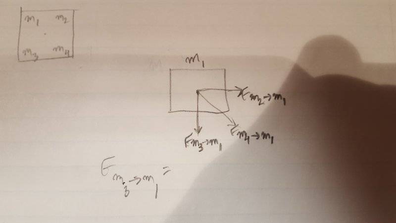

All I have done is start the free body diagram of one of the asteroids:
https://drive.google.com/file/d/0B2v0qfLe_-1Ea0JoZ2FuU1lNNmM/view?usp=sharing
Can I find the resultant of F m3->m1 and F m2->m1 and add that to F m4->m1 to find the total Fg towards the center?
I'm stuck. Any tips on getting started?

Can you post a (clear) picture of your FBD? You can use the UPLOAD button to upload a *.JPG picture. You should be showing the 4 masses at the corners of the square, with three force vectors shown on one of the four masses... Can you write the sum of the 3 vector forces on that one mass?

Your FBD looks fine. So now just write the 3 vector forces and sum them up vectorially. The force depends on the masses and the separation distances, as you listed in your OP. :smile:

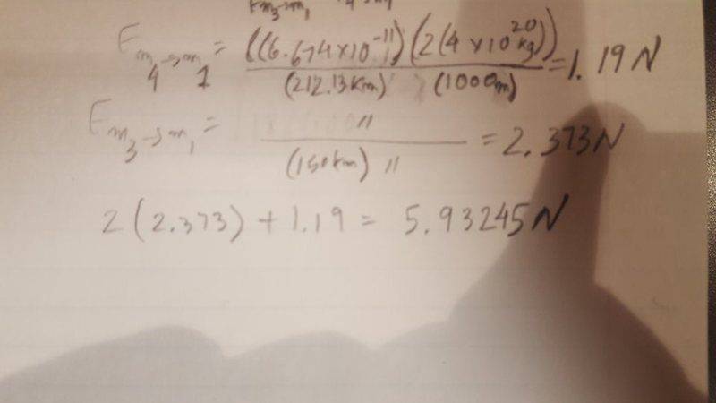

I calculated F m3->m1(2372978N) + F m2->m1(2372978N) + F m4->m1(1186400N) and got 5932356N
Is that correct?

Beats me. Can you show how you summed the x & y components of each force to get the overall x & y force components? And then how that gives you the overall magnitude and direction of the net force?

It's a little hard to read what you are doing, but it sounds like you are taking the right approach. I'd draw a new version of the 4-mass square, and label the 3 forces acting on m1 as vectors aiming at the respective masses. Then show separate sums for the x & y components, using an x-y coordinate system centered on m1. Then it should be easy to add up the vector components and keep going. :smile:

calculated the resultant of F m2->m1 and F m3->m1 = 3.356N
3.356 + 1.19(F m4->m1) = 4.546N
a = 4.456N/(4 * 10^20kg) = 1.114*10^-20 m/s^2
Since you're the only one replying, Can you please do the math to make sure the acceleration is correct?

But the three force vectors point in different directions. I'm not understanding how you handled that part...

If you are trying to calculate the gravitational force between two masses, m1 = m2 = 4 × 1020 kg, you must use the product of the masses, not the sum of the masses, in your formula.
m1 × m2 ≠ 2 (4 × 1020 kg)
