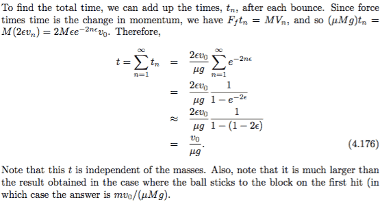

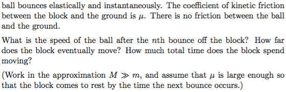

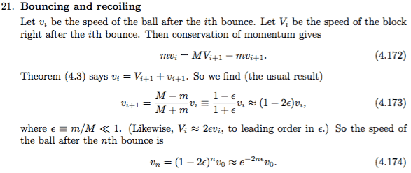

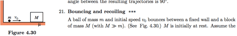

For the part on finding the total time the block spend moving, the answer is ##\frac{v_0}{\mu g}## (attached below).
I get a different answer if I use the impulse-momentum theorem:
The total change in momentum ##\Delta p=-mv_0##. The force ##F## slowing the block down is always ##-\mu Mg##. Thus the time ##t=\frac{\Delta p}{F}=\frac{mv_0}{\mu Mg}##.
Q1: Why are the answers different?
Also, I believe the time for the case where the ball sticks to the block on the first hit should be ##\frac{\Delta p}{F}=\frac{mv_0}{\mu (M+m)g}##, because the force on the ball-block combined mass is ##-\mu (M+m)g##. Q2: Am I right?
EDIT: I've found the answer to my first question. It is not correct to use the total change in momentum ##\Delta p=-mv_0## to find time ##t=\frac{\Delta p}{F}##.

I would have said the error was in overlooking the additional rightwards momentum gained from each bounce off the wall.

Me neither, but Happiness had specifically asked what was wrong with the reasoning. If I reverse-engineer the reasoning from the equation, I believe it's this: time block spent moving=(momentum lost by system)/(force of friction on system while block moves). The error in that is that it ignores the impulses from the wall at each bounce.
