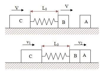

I divide into 2 collisions. the first is plastic between boxes A and B in which the members cling to one another. the final velocity of the boxes A and B is ##\frac{V}{2}## and i find it from conservation of momentum between box B and both boxes after the collision:
$$mV=2mv\;\rightarrow\; v=\frac{V}{2}$$
Now these 2 boxes collide elastically with C. the spring contracts, expands and reaches, again, the initial relaxed length L0. then and there the boxes A and B part and A continues alone.
One system consists of the boxes A and B and the other system is box C alone. conservation of energy+momentum:
$$\begin{cases}\frac{1}{2}(2m)V^2+\frac{1}{2}(2m)\left( \frac{V}{2} \right)^2=\frac{1}{2}(2m)v_1^2+\frac{1}{2}(2m)v_2^2 \\ 2mV+2m\frac{V}{2}=2mv_1+2mv_2 \end{cases}\;\Rightarrow\; v_1=\frac{V}{2},\; v_2=V$$
This is also A's velocity after it detaches, which happens at distance L0 again.
At some point, when the spring contracts to it's max, A and B halt momentarily. from the point of view of an observer on C all A and B's kinetic energy gets into the spring. A and B's velocity relative to C is ##\frac{V}{2}##:
$$\frac{1}{2}(2m)\left( \frac{V}{2} \right)^2=\frac{1}{2}kx^2\;\rightarrow\; x=\sqrt{\frac{m}{2k}}V$$
C's max acceleration:
$$ma=F=kx\;\rightarrow\;2m\cdot a=\sqrt{\frac{m}{2k}}V\;\rightarrow\;a=\sqrt{\frac{mk}{2}}\frac{V}{2m}$$

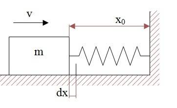

The distance between B and C is x. i want to find x as a function of t: ##x=f(t)## so that i will be able to differentiate it and find the maximum contraction. i can't. i use a simplified setting: a spring attached to a wall.
Lets say x is at distance x0 from the wall, the velocity there is v0 and it advances distance dx. the acceleration is ##F=kx=ma\;\rightarrow\; a=\frac{k\cdot x_0}{m}##. the acceleration in the interval dx is considered constant, and the mean velocity in dx is:
$$v-\frac{k\cdot x_0}{m}dt$$
from kinematics:
$$dx=\left( v-\frac{k\cdot x_0}{2m}dt \right)dt\;\rightarrow\;\frac{dx}{dt}=v_0-\frac{k\cdot x_0}{2m}dt$$
$$\int \frac{dx}{dt} dt=\int dx=x=\int v_0 dt-\int \frac{k\cdot x_0}{2m}dt^2$$
I don't know to handle dt2, if everything is correct till there, of course.

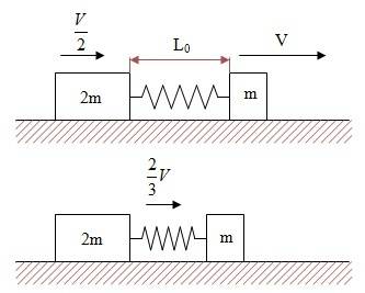

With A and B attached, The velocity of COM:
$$v_{cm}=\frac{2mV+2m\frac{V}{2}}{4m}=\frac{3}{4}V$$
In the COM frame the masses approach and move away from the COM at the same velocity:
So there is a momentary halt. the total kinetic energy:
$$E_k=2\cdot 2m\cdot\frac{V^2}{16}=\frac{1}{4}V^2$$
This is the compressed spring's energy:
$$\frac{1}{4}V^2=\frac{1}{2}kx^2\;\rightarrow\; x=\frac{V}{\sqrt{2k}}$$
$$F=kx\;\rightarrow\; 2ma=k\frac{V}{\sqrt{2k}}\;\rightarrow\;a=\frac{\sqrt{2k}V}{4m}$$

The max compression is for after separation, right? The speeds cannot both be V/4 relative to the mass centre then.
For the time in contact, they are only in contact for half a cycle, no?

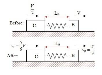

After separation ##v_{cm}=\frac{2}{3}V##. the relative velocity between C and B ##v_{rel}=\frac{V}{3}##
If i want to use the reduced mass ##\overline{m}=\frac{2}{3}m## then:
$$\frac{V}{3}=\omega A=\sqrt{\frac{3k}{2m}}\cdot A\;\rightarrow\; A=\frac{V}{3}\sqrt{\frac{2m}{3k}}$$
If i use the partial spring method, there is 1/3 spring between COM and C, i get the same A.
For the time they are in contact it's half cycle because B collides A when the spring is loose, at L0, and they separate at L0 again.
How do you get that relative velocity? Why does separation suddenly change it?
Correction, ##v_{rel}=\frac{V}{2}##, but that doesn't change the result for A.
The kinetic energy in the COM frame can be calculated using the reduced mass:
$$E_k=\frac{1}{2}\overline{m}V_{12}^2=\frac{1}{2}\frac{2}{3}m\frac{V^2}{4}=\frac{1}{12}mV^2$$
And it differs from the KE i found in post #3, where i also had a mistake:
$$E_k=2\frac{1}{2}\cdot 2m\cdot\frac{V^2}{16}=\frac{1}{8}V^2$$

But to get the maximum contraction after separation, I feel that working in the COM frame only complicates things. You can just consider the loss in KE in going from point of separation to when B and C are at the same velocities.
How do i find the common velocity of C and B after A parts?
Conservation of momentum on B+C.
$$2m\frac{V}{2}+mV=3mv\;\rightarrow\; v=\frac{2}{3}V$$
$$E_{k\ initial}=\frac{mV^2}{2}\left( \frac{1}{4}+1 \right)=\frac{5}{8}mV^2$$
$$E_{k\ final}=\frac{mV^2}{2}\frac{4}{9}=\frac{2}{9}mV^2$$
$$\Delta E_k=\frac{13}{72}mV^2$$
In post #3 i got:
$$\Delta E_k=\frac{1}{4}mV^2$$
Karol said:
##E_{k final}=\frac{mV^2}{2}\frac 49##
The mass is 3m here. Similarly, in the Einitial equation, one mass is 2m.
$$E_{k\ initial}=\frac{mV^2}{2}\left(2 \frac{1}{4}+1 \right)=\frac{3}{4}mV^2$$
$$E_{k\ final}=\frac{3mV^2}{2}\frac{4}{9}=\frac{2}{3}mV^2$$
$$\Delta E_k=\frac{1}{12}mV^2$$
Still different than in #3
I was never sure what the KE calculated as mV2/8 in #3, and corrected to mV2/12 in #12, referred to. I gather it was KE of A+B+C in "the com frame", but which com frame?
The mV2/12 in #12 is for the KE that goes into compression of the spring after collision. That agrees with the lost KE (of B and C) computed in #18.
There is still a problem with the amplitude A i got in #9
$$A=\frac{V}{3}\sqrt{\frac{2m}{3k}}=\frac{2}{3}\frac{1}{\sqrt{6}}V\sqrt{\frac{m}{k}}$$
While with the KE method:
$$\Delta E_k=\frac{1}{12}mV^2=\frac{1}{2}kx^2\;\rightarrow\; x=\frac{1}{\sqrt{6}}V\sqrt{\frac{m}{k}}$$
