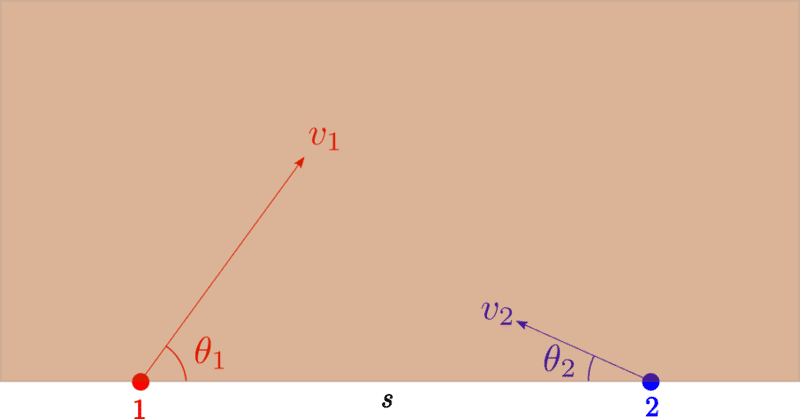

Shown in the picture below, two particles ##1## and ##2## are set into motion simultaneously from the edge of a table with velocities ##v_1## and ##v_2## at angles ##\theta_1## and ##\theta_2##. If their initial distance of separation is ##\boldsymbol{s}##, answer the following questions :
1. What is the necessary condition for ##1## and ##2## to collide?
2. Prove that for collision to be, the relative velocity is also the velocity of approach.
3. Find the time after which collision occurs.
1. For two particles of the given type to ##\textbf{collide}##, there should be ##\textbf{no motion}## perpendicular to the line joining them. This implies that one particle would "see" the other move along the line joining them.
2. Relative velocity between the two particles ##v_{R} = (v_1^2+v_2^2+2v_1v_2\cos({\theta_1+\theta_2}))^{1/2}##. (You may need to draw the diagram to convince yourself of this - it's not trivial).
3. For the two given particles, the velocity of approach ##v_A = v_1\cos\theta_1+v_2\cos\theta_2 = -\frac{ds}{dt}##
Problem :
The statement is given above. Here I attach the image of the problem to the right.
Attempt :
(1) Condition for collision : For the two particles to collide, there should be no relative velocity perpendicular to their "separation vector" ##\boldsymbol{s}##. Hence, we must have : ##\boxed{v_1 \sin\theta_1=v_2\sin\theta_2}## ##\huge{\checkmark}## (agrees with book)
(2) For collision, ##\boldsymbol{v_R = v_A}## : While I understand that the author's demand is a mathematical one, it can be show intuitively too. If the two particles possesses no relative velocity perpendicular to their separation vector ##\boldsymbol{s}##, the only other component of relative velocity is along their separation vector. But that is also the velocity of approach - proving the supposition. ##\\[10pt]##

You can do it formally with vectors. You know that
##\vec v_1 = v_1\cos\theta_1~\hat x+ v_1\sin\theta_1~\hat y## and that ##\vec v_2 = -v_2\cos\theta_2~\hat x+ v_2\sin\theta_2~\hat y##.
1. Use these to find an expression for the relative velocity ##\vec v_{\text{12}}=\vec v_1-\vec v_2## and set it aside.
2. Write expressions for the displacement of each particle relative to its starting point in time ##\Delta t##, ##\Delta\vec s_1=\vec v_1\Delta t## and ##\Delta\vec s_2=\vec v_2\Delta t##.
3. Find the relative displacement, ##\Delta\vec s_{\text{12}}=\Delta\vec s_1-\Delta\vec s_2.##
4. The velocity of approach is a measure of how fast the distance between the two is shrinking, ##\vec v_{\text{app.}}=\dfrac{\Delta\vec s_{\text{12}}}{\Delta t}.##
5. Compare it with the expression for the relative velocity ##\vec v_{\text{12}}## that you found earlier.

First let me say that your Autodesk sketchbook output is just fine and clear to read.
Secondly, question 2 asks, "Prove that for collision to be, the relative velocity is also the velocity of approach." You already know that, for the collision to be, the necessary condition is ##v_1\sin\theta_1 = v_2\sin\theta_2.## If you put that in your expressions, you get ##\vec v_{\text{app.}}=(v_1\cos\theta_1 + v_2\cos\theta_2)~\hat x.## That is a vector allong the line joining the masses at all times which in this case is the x-axis.
Thirdly, I am not sure what you mean by needing to find a vector method. Why isn't what you have in post #3 vector method? Did you mean a drawing with arrows instead of an equation with unit vectors? Perhaps you are misled by the drawing you posted because it is highly inaccurate. A diagram drawn to scale often clarifies and focuses one's thoughts (see below.)
