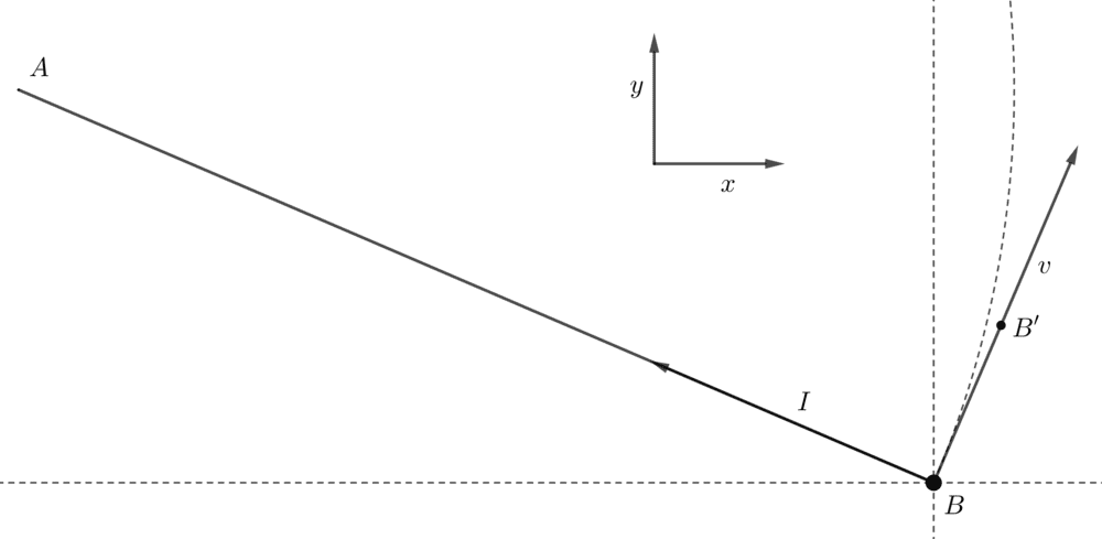

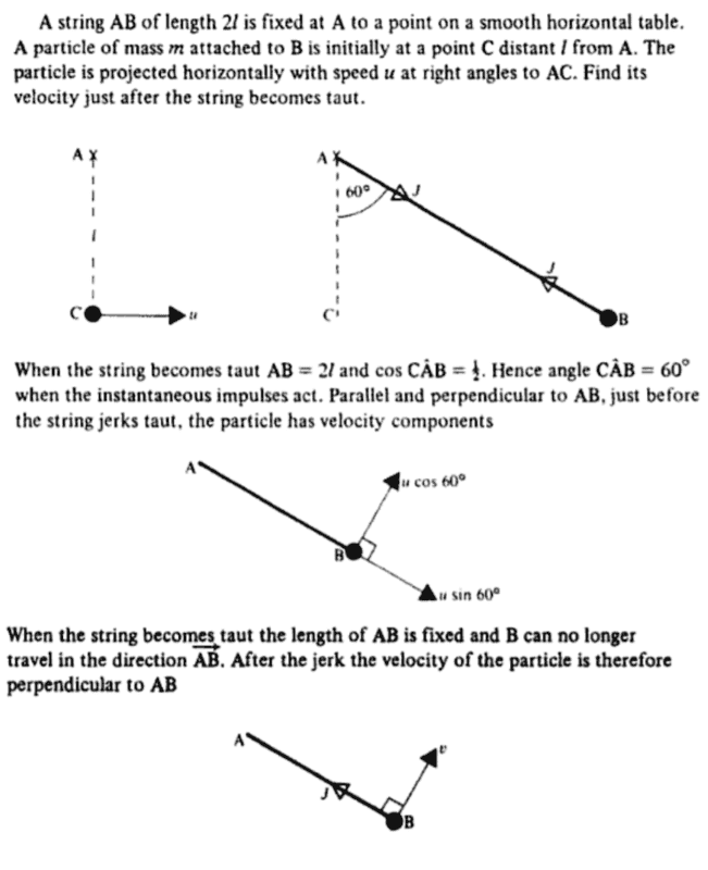

1. When an object attached to a fixed point with a string, is given a velocity and the string goes taut.
So it says in this book (Applied Mathematics 1 by L. Bostock and S. Chandler) that when the string goes taut, the component of the velocity of the particle becomes zero in the direction along the string.
  1. Why must that be the case? Is it not possible that the particle acquires a velocity in the opposite direction, i.e., along ##BA##, according to the example given?​
  2. If the velocity does for some reason become zero, what will happen immediately after the particle acquires this velocity? Is it only for as long as the impulse acts that there will be a tension in the string? Will there also be a tension after the impulse? How can it be calculated? Will the particle move in a circular path, and the tension be ##\dfrac{mv^2}{2l}##?​

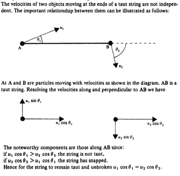

2. When a velocity is given to one of two objects are connected with a string, and the string goes taut.
The same book states that the final velocities along the direction of the string will be the same after an impulsive tension is experienced. Again, why must this be the case? What is wrong with the string not being taut? Can ##A## not move faster than ##B## after the impulse, and why?

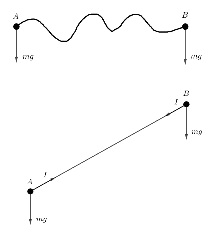

3. When impulsive tensions act in the presence of other forces.
  1. In this example, don't the weights of the particles have any effect on the impulse that arises?​
  2. Why do both particles acquire the same velocity due to the impulse?​
  3. What happens after these particles acquire these velocities? Will there be a tension present in the string? Is it possible to calculate it? Will both particles accelerate as a system with the same accelerations, or will they accelerate differently?​

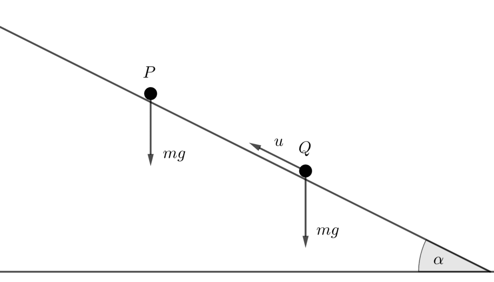

4. When two objects with external forces acting on them collide.
  1. If a particle ##P## that has a constant force acting on it, collides with another particle ##Q## moving at constant velocity, how will the particles move? Will they accelerate as a system?
  2. If ##P## is released from the top of an incline, and ##Q## is projected up along the incline at some velocity ##u##, what can we do to find out the velocities of the particles after the collision? If ##P## were instead thrown down the incline, it possible that after collision ##P## acquires a velocity greater than what ##Q## acquires, in the same direction? How will the particles move in such a situation?​
If the impact is taken as lasting negligible time then the impulse due to other forces, like gravity, is also negligible: p=∫F.dt.
For the duration of the impact, the impact forces are much larger.
Again, the question should specify inelastic. "Inextensible" doesn't cover it.
As before, easily calculted.
SilverSoldier said:
Does the presence an impulse and an external force along different directions, unlike in the pulley example above affect the problem in any way?
Again, negligible impulse during the impact.

haruspex said:
You can calculate this easily enough.
Mmm, do you mind telling me how? :frown: How can the tension that arises in the string be calculated, knowing only their initial and final velocities, and the impulse experience? By the way, in case it was not clear, I am not asking about the tension that arises in the string while the particle experiences the impulse, but what happens to the particle after the impulse finishes acting on the string.
haruspex said:
The impulse no longer matters; you just have the two masses moving with equal and opposite velocities
Also, point ##A## is fixed, and ##A## is not a movable mass, as I think you've mistakenly assumed.
We only know that the particle will have a velocity perpendicular to the string by the time that the impulse finishes acting, and that the string, I assume, will then be just taut.
If the particle should move with the uniform velocity it acquires, it must come to some such point as ##B'##, as indicated above, but it can't because the string is not that long. Will there also act another impulse along the ##x## direction, so the particle shall only move in the ##y## direction? Or will the particle start to move in a circular path?

jbriggs444 said:
As @haruspex wrote, you know how the objects are constrained to move after the collision. You know their velocities immediately following the impulsive event. So you can calculate how much tension is required to have them continue to move in the required manner.
What do you mean by tension required to have them move in the required manner? We do not get to decide how they move after an impulse, do we? How will they move?
From what I understand, they can either move in the ##y## direction, or move in a circular path. How do we know which of these happens? And if it should move in a circular path, how do we know whether or not it will do so with uniform angular velocity?
That is why @haruspex mentioned that the problem should specify an inelastic collision. Then you know that the radial velocity is reset to zero by the impulsive event. We know that there are no tangential forces. So we know that the angular velocity (or, at least, the angular momentum) will be uniform.
Given a non-zero initial tangential velocity and a zero initial radial velocity, the path taken by an object on a rope as it continues in motion is pretty clear.
In the real world, there are differences in ropes. A hemp rope will give you a pretty inelastic collision. With nylon, you'll get a bounce.
