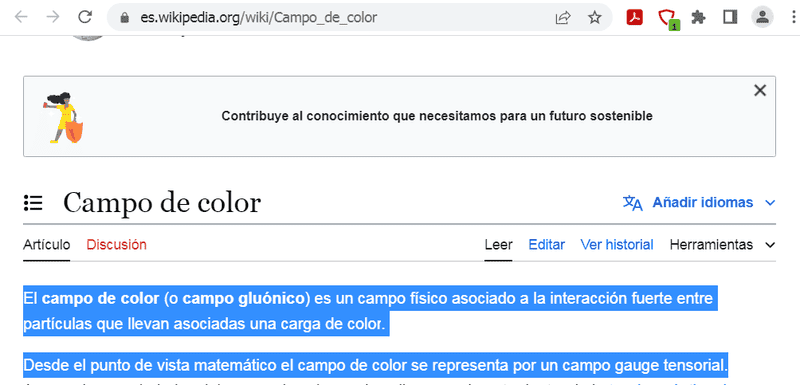

Article:
https://es.wikipedia.org/wiki/Campo_de_color
Specific part of the content:
El campo de color (o campo gluónico) es un campo físico asociado a la interacción fuerte entre partículas que llevan asociadas una carga de color.
Desde el punto de vista matemático el campo de color se representa por un campo gauge tensorial.
Translated:
The color field (or gluonic field) is a physical field associated with the strong interaction between particles that have a color charge associated with them.
From a mathematical point of view, the color field is represented by a tensor gauge field.

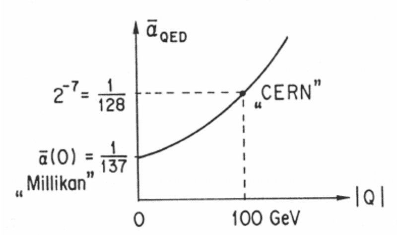

Fundamentally, neither electric nor color charge has a dimension. In quantum electrodynamics (QED, the theory underlying classical electrodynamics) the dimensionful elementary electric charge ##e## in coulombs is replaced by the dimensionless charge ##\mathscr{\mathbf{e}}=\frac{e}{\sqrt{\varepsilon_{0}\hbar c}}## and then used to define a dimensionless electric coupling strength ##\alpha_{\text{QED}}\equiv\frac{\mathbf{e}^{2}}{4\pi}=\frac{e^{2}}{4\pi\varepsilon_{0}\hbar c}##. This quantity is usually referred to as the fine-structure "constant", but it actually increases slowly as a function of the energy ##Q## at which it is measured:

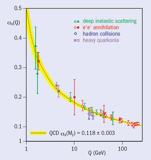

Similarly, the strongly-interacting theory of quantum chromodynamics (QCD) is characterized by a dimensionless color charge ##\mathscr{\mathbf{g}}## and the corresponding color coupling strength ##\alpha_{\text{QCD}}=\alpha_{\text{S(trong)}}\equiv\frac{\mathbf{g^{2}}}{4\pi}##. This strength is large at low-energies but rapidly diminishes at high-energies ##Q## ("asymptotic freedom"):

So the problems with challenges of the "metrology of charge" are include:
  • Charges and coupling strengths that are inherently dimensionless parameters.
  • Their values are a function of the energy-scales of measurement.
