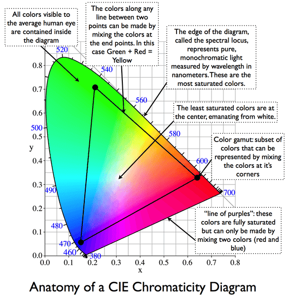

It could be worth while looking at the CIE chromaticity chart.
The resulting chromaticity of a mix of colours (points on the chart) is perceived as the centroid (weighted by intensity) of all the input colours. Assuming the spectrum of sunlight lies along the edge of the curve, the centroid lies in the white patch. Scattering will produce weighted values in favour of the blues and greens so the centroid will still be near the white patch - not near the spectral curve - and be perceived as bluish. That light will then be reflected upwards to the observer and this 'bluish colour' will be pulled back towards the white, making it a less saturated blue. The relative path lengths down and up will affect the result.

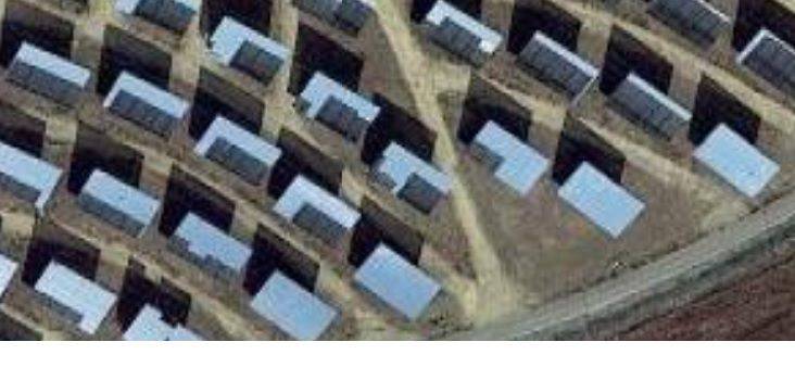

There are many solar power plants using large mirrors on earth. Their color as seen from the satellite is blue.
(source google maps: planta solar 10 Spain)
