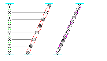

Lets have 2 horizontal mirrors, that is, one above the other. In the rest frame, the photon is set up to be linearly polarized such that its electric field goes in and out of the screen/page.
The points of maximal and minimal intensity are shown as circles in the left part of the picture. Photon is moving up.
(the green curve is simply a visual cue)
Now there are 2 lines of reasoning that contradict each other:
1. Middle picture
When viewed from a moving frame, the maxima and minima of the electric intensity should be at the same points, that is, at the same height. It means that the color of the photon should be red-shifted, as its wavelength is stretched by the factor ##\gamma##.
2. Right picture
The 4-momentum of the photon is, in the rest frame, (E, 0, E, 0). Boosting by ##v## and ##\gamma## in the x-direction, we get
$$E'=\gamma(E-v\cdot 0)=\gamma E$$
$$p_x'=\gamma(0-v\cdot E)=-\gamma v E$$
$$p_y'=p_y=E$$
Since the wavelength is ##\lambda'=1/E'=1/(\gamma E)=\lambda/\gamma<\lambda##, the photon appears blue-shifted.

A problem with argument 1 is the following. The wavelength is not just the spatial distance between two events at which the phase differs by ##2\pi##. The wavelength is the *shortest* distance between surfaces that differ in phase by ##2\pi##, at times that are *simultaneous* in the frame of reference being considered.

First of all, this boost does not correspond to the right-hand picture in your OP. In that picture, the photon is moving to the right; but that means the boost should be in the negative ##x## direction--i.e., the moving frame is moving to the left relative to the stationary frame (the one in the left-hand picture). So the minus signs in your equations above should be plus signs. (As a check, note that this leaves the sign of ##E'## unchanged but makes ##p_x'## positive, which it should be if the photon is moving to the right.)
Second, to know the Doppler effect--i.e., the energy/momentum of a photon as measured by a given observer--it is not sufficient just to know the observer's rest frame. You have to know the motion of the photon relative to the observer in that frame--whether the photon is moving towards, away from, or transverse to the observer (or something in between). In the previous thread you quoted, we were making implicit assumptions about that in order to derive the results we mentioned (that a left-moving photon in a right-moving frame is blueshifted, while a left-moving photon in a left-moving frame is redshifted).
Third, in that previous thread, we were talking about the special case where the boost is in the same or opposite direction as the photon's travel--i.e., the photon is moving either purely towards or purely away from the (implicitly assumed) observer. The case you are posing in this thread involves transverse motion, so you can't just carry over everything we did in the other frame and assume it works.

A rare circumstance - I think Peter muddied the water unnecessarily.
I think your OP scenario is perfectly well defined, with a unique answer. To clarify any doubt about the set up, note that while there is one receiver in the light clock rest frame, there has to be a row or receivers in frame in which the light clock is moving laterally - each at a current position of the clock's mirror, at rest in the second frame.
Then, with this understanding of the set up, answer (2) is correct, there will be blue shift and the transformed 4-momentum is correct, but a full justification requires fudged quantum mechanics or careful application of Maxwell's equations. Classically, it correctly gives the energy change per 'piece of beam' which could be one cycle, but there is no classical reason to expect this must match frequency change. You can use a fudged quantum argument, with an assumption of preservation of number of photons, or you can see Einstein's 1905 derivation of how the energy change in Doppler, aberration etc. happens to be the same factor as frequency change. Once this result is justified, one way or another, you can rely on 4-momentum transform to correctly describe any Doppler or aberration situation to the extent the geometric optics approximation is true.
Note that this is NOT a transverse Doppler situation where a redshift is expected. That situation results when the beam angle in the emitter rest frame is such as to be transverse between emission event and receiver in the receiver's rest frame. Then the red shift matches the time dilation factor. Here we have a situation where a detector placed so as to receive the beam must such that the emitter is partly approaching them. Classical doppler blueshift wins out over time dilation of emitter frequency, such as to match the transform of the 4-momentum.
To see consistency with Doppler, reference;
https://en.wikipedia.org/wiki/Relativistic_Doppler_effect
and look at the section "Motion in an arbitrary direction". The formula (2) of that section is most readily applicable to this situation, with cosθs being zero, due to transverse emission in the emitter rest frame, giving the same result as the transform of 4-momentum. Note, formula (1) of that section is the easy one for transverse Doppler, giving the expected result when cosθo is zero.

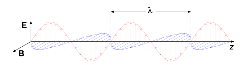

Re (1), a photon does not have electric and magnetic fields.
Pictures like this
are all over the internet... are they wrong?

SlowThinker said:
Pictures like this
I didn't say light doesn't have electric and magnetic fields. I said a photon doesn't have electric and magnetic fields, and I explained what "photon" means that makes that the case. "Photon" is not the same thing as "light"; a "photon" is a particular model of light that only works in a certain approximation, and in that model there are no electric and magnetic fields. Please go back and re-read my post.
SlowThinker said:
the points where both E and B fields are zero would be probably zero in all frames... if such points existed. So it looks like they don't exist?
Why would you think that? The picture you posted is not wrong; it just isn't a picture of a "photon". Again, please go back and re-read my post.
