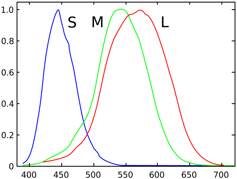

Based on the figure bellow we can estimate the sensitivity of the cones to the 480 nm light (R=0,15, G = 0,3, B = 0,3) and to the 600 nm light (R = 0,85, G = 0,35, B = 0). We are not seeing an equal amount of red, green and blue. I know that human perception is not linear, but I don't think this will make white.
Can anyone help me to figure out what is the outcoming color? Is there any simulator in which we can sum monochromatic colors by wavelength? Or any paper in this manner?

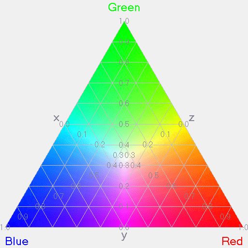

Blue and Yellow are complementary colours, lying opposite each other on Maxwell's Colour Triangle and on a line passing through the centre. All colours obtained by mixing varying proportions of Yellow and Blue lie along this line and we never obtain Green. At the centre we obtain White.
Please remember that colour mixing creates psychoperceptual colours, not physical ones.

There are simulators of human color perception out there, google can help find them. Here's one paper about that (which I chose mostly at random).
But I think delving into the biology of human perception isn't really the point of a physics test. Frankly it's a complicated mess with the spectral response of 3 photorectors, etc. I like @kuruman's approach; where do the fringes overlap?

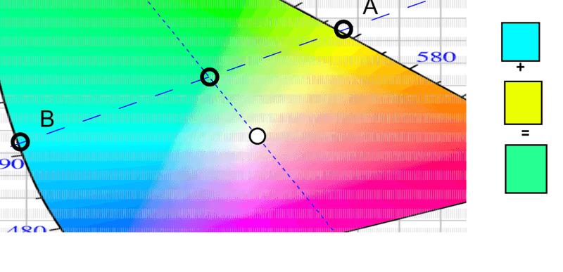

The CIE chromaticity diagram is a plot of colours 'as they are perceived'. It is based on the eye's analysis curves and the Maths has eliminated the Luminance. Unlike the Colour Triangle, it uses and gives numbers when colour matching is involved and it works (additive mixing of course). If you plot two colours on the CIE chart then the resulting perceived colour will lie on the line joining the two points at the 'centre of mass' of the weighted levels of the two colours (considered to be Primaries for experiment but they don't have to be R,G or B).
People are sometimes pretty dismissive of the CIE chart but it's pretty damn good where colour TV is concerned and it will work a treat for this problem.
Assuming the two light sources are spectral then they will lie on the curved (spectral) portion of the chart. Depending on the levels of each, the result will lie somewhere on the line joining the points.
I should point out that spectral colours can only be synthesised from single frequency (line) sources ; the Yellow cannot come from a combination of Red and green sources. (Close, maybe but no cigar.)
To get a green line from the two slit interference pattern, you choose where the 'green' that you want is, on the spectrum. Draw a line from the 'White' reference point (somewhere in the centre) and then work out what proportions of the two primaries to give a resultant where you want it.
This link shows the sort of thing I'm talking about. If you look at a line joining 480 nm (blue) and 600 nm (yellow), it passes through or below the white in the centre so 'they' are right because no combination of the chosen B and Y can give any Green. A very pale blue / cyan source, mixed with a very orange red could give a very de-saturated green - I would have copied the diagram but only a screenshot seems to work. Here's an alternative image:

A colour near 'spectral Green' can be used as a suitable primary colour because its position on the CIE chart gives it a good coverage of possible resultant colours when used in conjunction with two other suitable chosen primaries. (i.e. within a nice big triangle or 'gamut').
It is true that a spectral 'primary' can't be synthesised with two other colours (or even spectral wavelengths) because a chord across the curve is the closest you can get.
