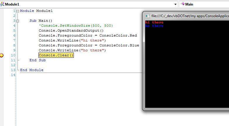

Hi,
I've written some code in VB6, and I'm trying to figure out how to add color to individual words and numbers.
The program is a console application Roulette game. What I need to figure out is how to make my money green if positive and red if negative, and color the words "red" and "black" as they appear in the display. Any help is much appreciated. I'm a beginner.

Console.ForegroundColor = ConsoleColor.Red
Wouldn't that just change the entire console color?
Why don't you try it and see?
Tried it. I managed to change the entire console foreground, but that's not what I am trying to accomplish.
I don't know what the problem might be. I wrote a sample program and all worked fine.
You could try setting ForegroundColor to red just before you print the text that should be red, and then set ForegroundColor to black afterwards. I haven't tested this, but I believe that you can set this property so that different words are different colors.
Edit: This is essentially the same as what phinds suggests, but he beat me to the punch.
I only want one word in a line to be colored, and they need to be specific words, like "Red" and "Black". Also, I need a variable to be green if it's positive, or red if it's negative. I have no idea how to do this.
Look at the example that phinds shows. He is coloring a line at a time using WriteLine. You can color a word at a time by using Write.
The basic idea is:
  1. Change the foreground color to the color you want.
  2. Use Console.Write to display the text
  3. Change the foreground color back to the default color.
One problem that might be insurmountable is that you are using a very old version of VB that dates from 1998. The example that phinds wrote uses a much more recent version, so I'm not sure what capabilities your version of VB has. It's possible that in your version there is no ability to change the color of text.

The trick here was to change a portion of a sentence to a different color, then change back to the original console colors. I still haven't figured out how to make the 'bank' variable become red if it's negative though, it's always just green.
Code:
If bank < 0 Then
Else
   Console.ForegroundColor = ConsoleColor.Green
End If
TurtleMeister said:
Actually I think the latest version is code named VB14. It is bundled with Visual Studio 2015 Community along with C# and C++. I tried it out before it was released (the RC version), but after a about a weeks use the IDE crashed and became unusable (It may be more stable by now). So I went back to my VS 2012 express version. I don't know if the express versions are still available, but if they are one of them might be a better choice for someone using an older PC. The 2015 community version IDE was a bit sluggish on my computer.
Code:
If bank < 0 Then
Else
End If
That must be what I'm using, since the IDE I have is VS Community 2015. My laptop is pretty new with an SSD and an i7 processor, so I haven't noticed anything really.
Also, wow, that worked. I had to place it in the sub-routine after the user places their bet.
