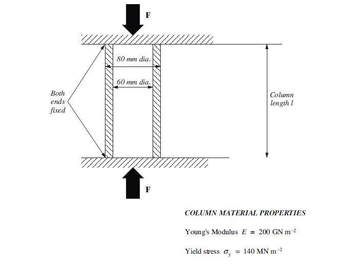

Column buckling answer confirmation
In summary, the buckling equation for a column is F= ((∏^2)*E*I)/(K*L)^2, where E is the modulus, I is the area moment of inertia, K is the buckling coefficient, and L is the length of the column. For a hollow tube with a mass moment of inertia of I = (0.08^4-0.06^4)∏/64 = 1.37 x 10^-6 m^4, the minimum length for buckling to occur is 5.93 meters. The value of K for fixed-fixed end conditions is 0.5. The question about the mode of failure and the load at which failure would occur can be solved
charger9198
60
https://www.physicsforums.com/attachments/42439
What is the minimum length of the column at which buckling is likely to occur?
The buckling equation is: F= ((∏^2)*E*I)/(K*L)^2
the mass moment of inertia for a hollow tube is;
(using meters)
for the force, F, that will cause yielding.
The equation is:
σ= F/A
The cross sectional area of the column is:
Need to convert MN/m^2 to GN/m^2 by multiplying by 10^-3.
Therefore, F = Aσ = 0.02 x 141 x 10^-3 = 3.08x10-4 GN
Therefore, rearange the equation and solve for L
L= (SQRT) ((∏^2)*E*I)/F*k^2 = 5.93 m
This means, if the column is longer than 5.93 meters, it will buckle due to slenderness. Otherwise, if it is shorter than 5.93 meters, it will not displace out of plane and fail in yielding.
charger9198: MN/m^2 is called MPa. And GN/m^2 is called GPa. Always use the correct, special name for a unit. E.g., 140 MPa, not 140 MN/m^2.
If you have written the problem statement in post 1 exactly as given, then it might indicate the instructor has a limited understanding of buckling, because the question is unclear. A column can buckle at almost any length, if the applied load is high enough (i.e., as we move toward, and into, the inelastic range). The question would be more clear if it were instead worded as follows. "What is the minimum length of the column at which elastic buckling is likely to occur?"
Currently, the best assumption is to assume the word "elastic" was intended to be inserted by the instructor. Also, we might assume the instructor wants you to pretend the column is theoretically perfectly straight.
Therefore, using these assumptions, your current answer, 5.93 m, is correct, or close to correct. (You rounded numbers in your intermediate calculations too much. If you had maintained at least four significant digits throughout all your calculations, which you should have done, then you would have obtained 5.94 m.) Also, you should use 140 MPa, not 141 MPa.

Charger: you wrote "This means, if the column is longer than 5.93 meters, it will buckle due to slenderness. Otherwise, if it is shorter than 5.93 meters, it will not displace out of plane and fail in yielding."
Columns under load can displace out of plane without it being buckling. The test is whether on removal of the load, the column returns to its original position. One definition of buckling load is: If you displace the loaded column with a perturbation and it remains displaced, then it has buckled. NVN's advice is always good, but just don't believe that the results of the calculation are true to the number of significant figures you are using. In my experience you would be lucky if two sig figs were to correctly predict a column buckling load, there being very many variables that the theory ignores.

Hi all, I also have this question as part of my assignment and I was getting a different answer.. I was wondering how you know what shape the column is from the question? You can get rectangular columns too, can't you? :/
The dimensions from the problem statement attachment list '80 mm dia.' for the outer dimension and '60 mm dia.' for the inner dimension. 'dia.' or diameter implies a circle rather than a square or rectangle.

I'm almost certain that the column length is 5.236389088 m.
Disregard my last post. I used the wrong formula for A and K. Now I am on it. Its around 5.9 m off the top of my head.
Hi All
I have just looked at this problem and just wanted to confirm my answer, which is different to everyone else!
The question stated the diameters of 80mm and 60mm with E = 200GNm^2 and σ = 140MNm^2
To calculate the minimum length of the column at which buckling is likely to occur
ESR = L/k, so L = ESR x k
ESR = √pi^2 x E / σ
ESR = 118.74k = √I/A with I = pi( R^4 –r^4) / 4 and A = pi( R^2 –r^2)
With R = 40mm and r = 30mm
k = 0.025mWhich gives the minimum length as 2.97m (118.74 x 0.025m)
mamike1515 said:
Hi All
ESR = √pi^2 x E / σ
ESR = 118.74
k = 0.025m
The slenderness ratio L/r uses the effective length of the column, instead of the actual length. The effective length is determined by the support conditions at the end of the column. For a fixed-fixed column, the theoretical effective length is equal to half of the length between supports.
Thanks Steamking.
Looks like I missed the column design notes!
So Le=L/2
L=Le x 2
L=2.97m x 2 = 5.94m, which is the minimum length of the column at which buckling is likely to occur.
Hi, I'm currently doing this question and am a little stuck on the last question.
Answers i have already are as follows: (I'm happy with these)
1. What is the minimun length of the column at which buckling is likely to occur
ANS = 5.937 m
2. If the column is the length determined in the last question what would be the mode of failure
ANS = Buckling
3. At what load would you expect failure to occur
ANS = 3.078 x 10^5 N
4. If the column is half the the length determined in question 1 what would be the mode of failure.
ANS = Crushing (i'm assuming this as the minimum length for buckling is 5.937 so anything less must be crushing
This next one is the one I'm struggling with
5. At what load would yo expect failure to occur.
I don't need the answer, just pointing in the right direction. I'm assuming it isn't as simple as
F = σ * A
Thanks for reading.
You are on the right track by using Eulers equation and the question is asking what load would the failure occur?
Remember Eulers Equation isn't just Fc=σ*A it is also pi^2*EI / Le^2.
Also remember that the column is fixed at both ends
Thanks for your reply,
if I use pi^2*EI / Le^2 I get a fiqure of 1.231 x 10^6 N
This is just using the same formula i used for Q3 but I halved the length.
If I've got it right great, I was just expecting something more complicated for some reason.
Kampftrimker, it looks fine to me.
Basically halving the length of the column increases the load failure by approx 4 times
