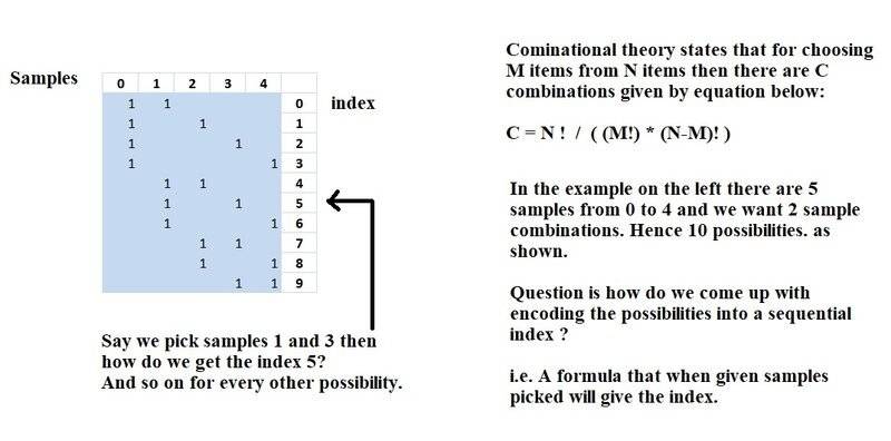

How to come up with an indexing formulae for all set of combinations from a given set of numbers?
The Combinations formulae will find the number of possible combinations that can be obtained by taking a sample of items from a larger set.
C = n! / [r! * (n-r)! ]
Where n is the number of set samples and r is the number of desired selected samples.
So as an example say we have n=5 and r=2.
Here are all the possible 10 combinations for choosing 2 samples out of 5 samples as shown in attached picture.
Note a 1 is a selected sample.
My question is given a chosen sample combination can we come up with a formulae that can map it to its index value ??
So say we come up with combination samples 1 and 3 then how do we get to index 5 ??
Technology news on Phys.org
What do ,"chosen sample combination" and "index value" mean here?
In the example I have chosen we have 5 samples in our data set. So n =5.
I have selected r to be 2. So we are looking at 2 sample combinations out of 5.
As shown in the attached picture in my original post the 2 sample combinations are indicated as 1s.
So in the table first 2 samples combination is sample 0 and sample 1. Next combination is sample 0 and sample 2 and so on. There are a total of ten 2 samples combinations as shown in the table.
Now let's say we map each of the 10 combinations to an index value. This way rather than say what the 2 samples combinations are I like to give the index and use a formulae to calculate the 2 samples combinations.
So if I say index 5 then one should be able to calculate, through a known formulae, that the two chosen samples are samples 1 and sample 3 as shown in the table. And so on for each index value.
Hope this clarifies it a bit.
I think you should figure out first how to get the index from the two samples, ##s_1## and ##s_2##.
\mathrm{index} = \frac{1}{2} \left[ (2n-1) s_1 - s_1^2 \right] + (s_2 - s_1)
Thank you DrClaude for this formula.
Given the example I posted I assume n=5, S2 is S(i+1) and S1 is S(i) where (i) is the sample position from 0 to 4.
You formula works for the example that I have given and the index goes from 1 to 10 which is fine.
But I was looking for more of a generic way to code this regardless of the numbers in the data set or the number of samples chosen.
What happens when we choose 4 samples out of 10 data sets ? Here we get 210 possible combinations.
I know a long time ago I came across this problem and I believe there was a solution as how to decode a given index knowing (n) and (r). but I have lost the paper and I can not find it anywhere on line.
So if anyone knows how to do it in a more generic way pls do let me know.
I will play around with your idea to see if I can make it for other possibilities.
Thanks again
Let's see, sounds recursive to me.
With no attempts at optimization:
