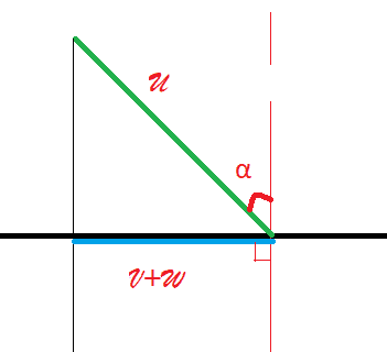

A boy is situated at point A in a river, at distance
a from the riverbank. He can swim at speed u or run at speed
v > u on the shore; water flows in the river at velocity w > u.
The boy wants to reach the point C upstream on the riverbank
with minimal time. At what distance x from point B aligned
with point A should he get out of the water?

I took water frame of reference so his land speed is now (v+w) and time taken to cover x is let say 't' x = (v+w)t
now time it took to cross come out of river be 'T' so hyp = uT now angle be α so sinα = uT/(v+w)t is there a possible relation between T and t?

well tried a different approach I studied earlier we have according to water frame of respect velocities v+w and u so we are assuming that the boy didn't took any break when going from water to land so I applied snells law and got sinα = (u/v+w) so alignment angle α = arcsin(u/v+w) is it correct approach?? and what to do next?

View attachment 258768 well tried a different approach I studied earlier we have according to water frame of respect velocities v+w and u so we are assuming that the boy didn't took any break when going from water to land so I applied snells law and got sinα = (u/v+w) so alignment angle α = arcsin(u/v+w) is it correct approach?? and what to do next?
That looks like the correct equation for ##\alpha##. That was an imaginative approach!
You should be able to calculate ##x## now you know ##\alpha##.

x will be a*tanα
IamVector said:
x will be a*tanα
but when i checked the answer its
x = a( w/(u cos α) − tan α)

You need to be careful, since you used frame moving with respect to the bank.
Likes IamVector
ohk just realized thanks for help. : )

here is the approach I saw in hint given below also it says that using huygens principle is considered the shortest way to solve such problem
approach :
once the front meets the point A, the front forms
a cathetus of a right triangle AP Q, where Q is the point
where the front meets the riverbank, and P is the position
of that Huygens source on the riverbank which creates the
circular wave meeting the point A. Notice that the point
P is the point where the boy needs to start swimming in
the water’s frame of reference, and is displaced by wT from
the corresponding point in the lab frame.

Using calculus you need to minimise ##(1 + \frac w v) \sec \alpha - \frac u v \tan \alpha##. Which you do by usual differentiation method.
