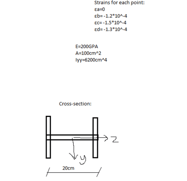

Find Fx and Fy.
I tried calculating σα,σb,σc,σd using σ=εE for each point since i know the strains for each point. Then took the section from the top to points a,b. Fx will create a bending moment M and Fy is axial force, so for a: σα=-Fy/A - Mz/Iyy which has 2 uknowns the Fy and M. I do the same for point b: σb=-Fy/A +Mz/Iyy and solve a 2x2 system and find Fy and M. Not sure so far

morpheus343 said:
Homework Statement: Find Fx and Fy.
Relevant Equations: stress

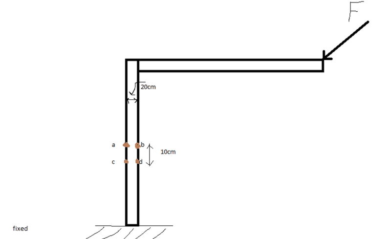

Can you break the diagram into two pictures so the text is larger?
Should be visible now

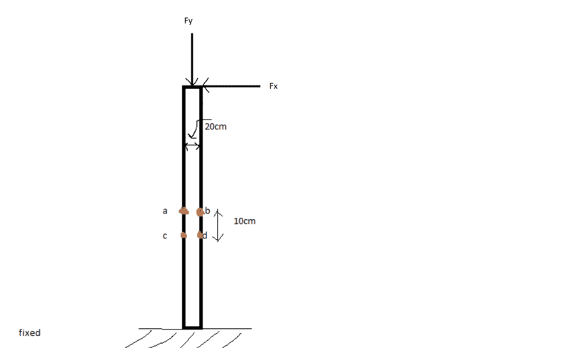

Ok, go ahead and replace with its effective loading at the top of the column so we are clear.
Then proceed with finding the reaction forces at the base. It's a good idea to produce shear moment diagrams, as it should help you find an error (I believe) you are making.
I need to add a moment at the top?
I'm assuming they have given the length of the beams?
No

The internal moment at a random length x is M=Mtop+Fx*x ?
You have the right idea, but you are applying things incorrectly. What do you find for the reaction moments, forces at the base of the column. Please draw a diagram turning that portion horizontal.

morpheus343 said:
What direction is the moment at B? And what is its value in terms the assumed beam length ?
counterclockwise?
morpheus343 said:
counterclockwise?
It's the external effect of (applied at distance ) on the beam. Just like the forces. What direction is it?
you mean it should be clockwise to counteract the rotation that Fy creates?
Fx * when perpendicular
No it should be clockwise because it is the rotation creates. We are not looking at an internal force there. We are looking at external forces/loads at . We are replacing the external loading condition out at the end where is applied, with an equivalent external loading condition at the column.

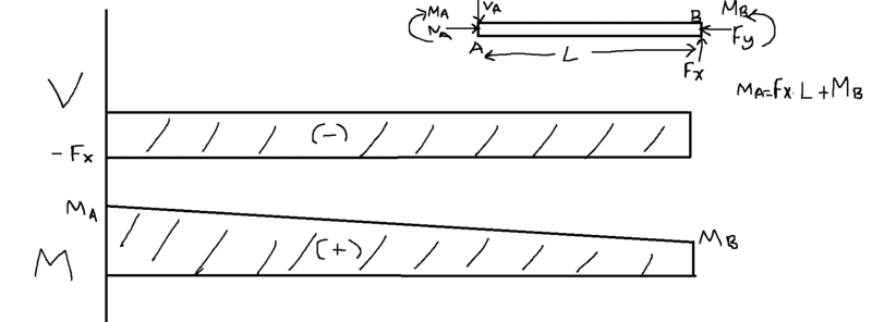

So are you good on the whole problem, do you see the issue?
Your shear/moment diagrams suggest you might be having sign convention issues, and the internal moment should be
is negative according to convention, so it has to cross the axis.
I am not really sure, so if i cut the beam at points and ,both and will create a bending stress and also a normal stress? Would this be the way to solve it, cutting 2 times once at , , and once at ,

In order to find the bending moment at each point
  • #32
Yes, the moment at section and are defined by which is a function of .
Before you were applying the same moment at point and . But they are apart. So they don't have the same internal moment.
You have two other points to consider, so maybe you can even solve for , I don't know...You'll have to try that out.
To me it appears as though section is at but that isn't specified anywhere - I'm skeptical, but who knows.
Also, it’s not clear whether or not the height of the I beam ( )is to be neglected against , that would factor into your external moment.
  • #33
I see, i will work the algebra and see if i can solve it, but i think there are too many unknowns.(, , , , distance). And i only have 4 equations, one of each of the combined stress at each point. Thank you for your time and help
