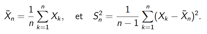

3) i looked at multivariate normal distribution. When you have a list of random variables X1, X2,..., here is the expression for the mean and sample variance (basically what I'm looking for, i think) :
But i can't find how to calculate this if the X1, X2, ... are not iid (independant and identically distributed), because in my problem, they are independant but they are NOT identically distributed since N(bi, SE(bi)) is different for each 'i'.
4) For the mean it seems to be pretty straightforward and just be the mean of the bi. The standard deviation is the real problem to me.Please help :(
The expression for ##\overline{X}_n## is the definition of the statistic called the "sample mean" of a sample with values ##X_1,X_2,...X_n##. The expression you give for ##S^2_n## is one possible definition for the "sample variance" of such data. These definitions do not specify any conditions on how the values ##X_1,X_2,...X_n## are generated. In particular they do not say that the each ##X_i## must be an independent realization of a random variable or that each ##X_i## must be an independent realization drawn from distribution of some single random variable ##X##.
Speaking literally, there is no problem calculating those statistics if you have specific set of data. They don't depend on how the data was generated.
A function of random variables is itself a random variable. So if we are in a situation where the values ##x_1,x_2,..,x_n## are regarded as realizations of ##n## random variables, then a statistic ##s(x_1,x_2,...,x_n)## is a random variable. As a random variable ##s## has a distribution. That distribution has parameters. For example, we can speak of "the mean of ##s##" in the sense of the mean of that distribution. If we have ##m## vectors of data of the form ##(x_1, x_2,...x_n)## realized from ##n## random variables, we can compute ##m## values ##s_1, s_2,...s_m## of the random variable ##s##. We can define statistics on such samples. For example, on a sample of ##m## values of ##s##, we defined the statistic called the sample mean.
This shows why discussing even the simplest problems in statistics becomes conceptually complicated. A statistic has its own statistics - in the sense of statistics defined on samples of the statistic. A statistic can be regarded as a random variable and a random variable has a distribution, so a statistic has parameters - in the sense of the parameters of its distribution. Parameters of a distribution are constants, not statistics. But statistics are often used to estimate parameters.
When that is the goal, we call the statistic an "estimator" of the parameter. This is the context where we begin to care about how sets of data ##x_1, x_2,...x_n## are generated - whether they are independent realizations of the same or different random variables, whether the random variables have particular types of distributions - normal distributions or uniform distributions etc.
If we know particular things about the distributions that generate the data, we can say particular things about the distribution of a statistic that is a function of the data.
