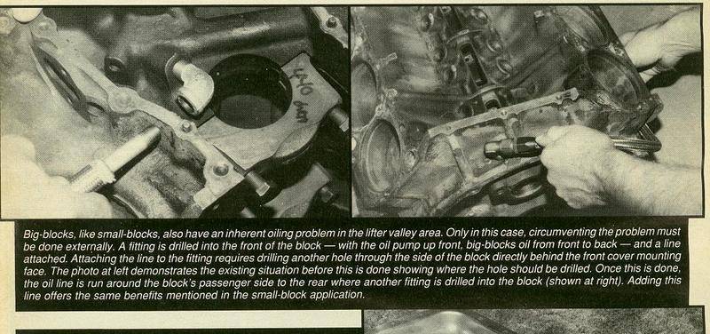

Big block 440 s have stock external oil pump. the pick up is at front of the oil pump sump. Fine for granny and grocery getting but when you romp on it, oil sloshed to the rear of the sump and the pick up gulps air..not good for bearing..So we add the 1/2 ID Hemi oil pick up and go to deeper sump. One problem is that the oil runs through the oil galleries that are partially blocked by the lifters. As rpm increases oil is churned to the point it starts to foam..( air bubbles and oil mixture) this causes drop in oil pressure ( locally) and created air gaps. This is the same gallery that oils the crank bearings and finally the rod bearings.The oil has to pass through 4 lifters to get to number 4 rod bearing and is moving too fast to make the 90 degree turn. The reason the number 5 , 6 ,7, 8 bearings don't starve is because the oil backs up when it hits the narrower oil passage going to the valve train. The small block Chevy boys plug this gallery and drill a smaller id hole to keep the oil down stairs.
To fix this problem we run a external braided oil line from the oil pump to the left rear of the block where the oil pressure sender usually is. This cures the problem by pushing non aerated oil to the galleries from both ends. This way you have oil coming in from both ends and meeting in the middle.

Wowzers! Thanks, Mike. I never had access to any fancy books, and this was long before the internet, let alone home computers, existed. This is the first explanation that I've seen for why those bearings go bad.
yea Danger..I ran this set up on my 68 Road Runner..493 cid block..ihad a remote oil filter that had an extra oil outlet and I tapped out the gallery on back of the block and ran an Aeroquip line to it.

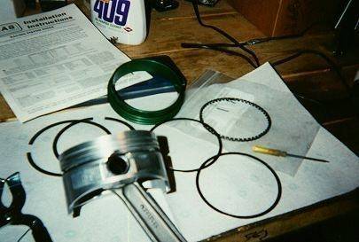

here is my engine with hemi pick up and windage tray also note piston has minimum weight, stock 440 rods that are lightened

I don't know what sort of pick-up I have, but it's obviously extended since it came with the 8-quart Moroso deep-sump pan. I seem to recall that it's free-swinging, and the pan is baffled. The windage tray is factory stock.
The pistons are "race-only" 12:1 aluminum TRW's mounted backwards in the bores and holding 1/16" double-moly rings with .008" end gaps. The rods are also TRW's that came with the pistons. Rod and main bearings are CL77's. Although there was nothing wrong with the original crank that couldn't be machined down, I chose to replace it with a forged steel unit which I think has chamfered oil holes.
Minimum ring gap for that bore on the street should be .020". Tighter than that and you risk butting and breaking the rings.
