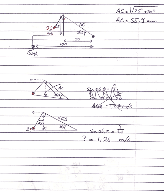

Power = Force X Velocity. If you want the 75 N force to move at 0.5 m/s, then it requires 37.5 W of power. Since energy is conserved (so is power), then your actuator also needs to produce 37.5 W of power.
Thanks. The location where the speeds applies doesn't play a role in this? To be clear what I mean, if I got a big truss construction included with a lot of beams with joints (so rotation is allowed), if I want this construction a speed of 5 m/s at the output, I can calculate the Power with only the force at the output multiplied by the speed?

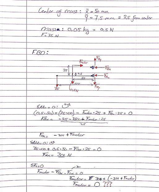

I re-calculated the FBD (see below). Now I find a force acting on the motor of 0 N ?? I am quite confused now o_O... The sketch includes a view of the Pivot joint which I have in mind, how should friction be added to this?
To keep it simple, say you have only your 75 N force, moving at 5 m/s.
Doing a sum of moments about point A will give a horizontal force of 300 N at point C (basically, ##75\ N \times \frac{100\ mm}{25\ mm} = 300\ N##).
To find the horizontal velocity at point C , you first find the velocity at point C. The center of rotation is point A, thus the angular velocity is ##\frac{5000\ mm/s}{100\ mm} = 50\ rad/s##. Using the arm length AC - ##\sqrt{25^2 + 50^2} = 55.9017\ mm## - you can find that the velocity at point C is ##55.9017\ mm \times 50\ rad/s = 2795\ mm/s## (or 2.795 m/s). That velocity is perpendicular to the arm AC, i.e. at an angle of 26.5651° (##= atan\left(\frac{25\ mm}{50\ mm}\right)##). The horizontal component of that velocity is thus ##2.795\ m/s \times \sin 26.5651° = 1.25\ m/s##.
The power required at point C (horizontally only) is force times velocity, or 300 N X 1.25 m/s = 375 W. Surprise, surprise, it is the same as 75 N X 5 m/s = 375 W. That is because, in a system, energy cannot be destroyed, it is conserved. Since there is only one input point and one output point, they must be equal.
Now you can add other input forces, such as the frame inertia (frame mass times its acceleration, including gravity) or you can add a http://mechanicsmap.psu.edu/websites/6_friction/bearing_friction/bearingfriction.html at the different pivots. All of these will alter the horizontal force at point A. But the velocity will remain the same. If you calculated the sum of all these powers from each input point, it would also be equal to the new calculated linear actuator power.
You shouldn't include forces at point B in your diagram. Only consider the forces acting on the frame.

Why you're doing 5000 m/s / 100 mm? Is this the speed around point A? I looks to me more or less like a ratio? (I added my sketch below).
Maybe a stupid question but why should only forces acting on the frame be considered? The motor can kind of 'unload' his force into this pivot point B?
angular velocity = velocity / radius, or ##\omega = \frac{v}{r}##
The angular speed to be precise.
It is not a ratio because the units are different. It is a velocity divided by a length: ##\frac{5000\ \textbf{mm/s}}{100\ \textbf{mm}}##

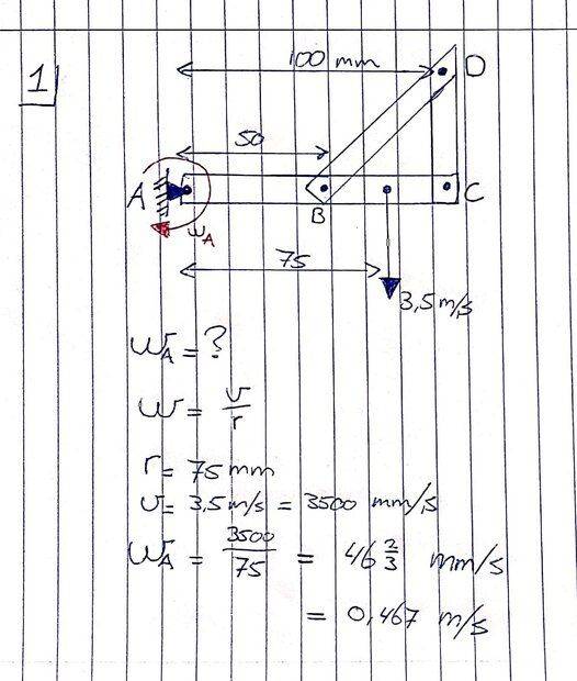

So if I take a closer look at the axle in point A and apply the 3.5 m/s, the axle at point A with rotate with an 'angular velocity' of 0.467 m/s?
No. Units are important. You cannot mix mm and m. You must convert to the same unit:
$$\frac{3.5\ m/s}{0.075\ m} = 46.7\ rad/s$$
Or:
$$\frac{3500\ mm/s}{75\ mm} = 46.7\ rad/s$$
Note also that the angular velocity has the units of radian per second.
Sorry, sloppy mistake from my side. So in this particular example I cannot calculate the velocity (m/s) at point A because point A is where the frame is rotating around?

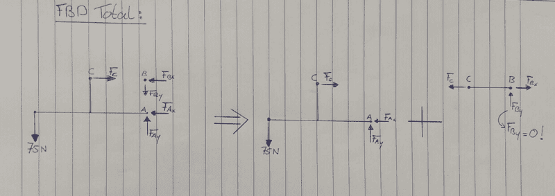

The FBD's are shown below. I doubt about situation 3, I think as sketched is what you meant earlier?
So to correct this above, should be: The shaft/axle at point A will rotate with a angular velocity of 46.67 RAD/s or 445.75 RPM. The speed (v) at point A is 0 because length of the arm is 0.
Correct.
Sketch 1 is OK. (Usually ##F_{Ay}## should be upward, but that just means your value will end up being negative)
Sketch 2 should be a drawing of the actuator:

Note that ##F_C## of sketch 2 is equal and opposite to ##F_C## of sketch 1.
As for a free body diagram for the ground, forget about it, you don't need it. I just wanted you to understand that the ground plays a role as a link; A special link that is considered fixed.

Can I make it as the sketch below? So make one 'main' FBD with all forces occurs at the frame, then split it to the two FBD diagrams? I think the penny has been dropped if this is the case.
On the left-hand side, you have to remove the force ##F_C## (which will be an internal force) and add the link ##CB##. It will still be a valid FBD for the whole assembly.
Hmm Okay, it should be like below? The actuator is replaced by a rigid connection?
