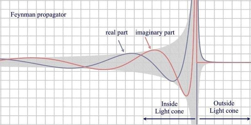

(from the notes of my book)
Calculation of the diminishing part outside the light cone of Feynman's
Klein Gordon propagator in configuration space
The propagator in momentum space and configuration space:[tex]
{\cal D}_4^{\cal F}(x,y) = \lim_{\epsilon \to 0} \frac{1}{(2 \pi)^4} \int d^4p \, \frac{e^{-ip(x-y)}}{p^2 - m^2 + i\epsilon}
[/tex]
[tex]
= \left \{ \qquad \begin{matrix}
-\frac{1}{8 \pi} \delta\left(\tfrac12 s^2\right) +
\frac{m}{8 \pi s} H_1^{(1)}(ms) &~~~~~~ \textrm{ if }\, s^2=t^2-r^2 \geq 0 \\ & \\
-\frac{i m}{ 4 \pi^2 s} K_1(ims) &~~~~~~ \textrm{if }\, s^2=t^2-r^2 < 0
\end{matrix} \right.
[/tex]
In this section we'll turn our attention to the problematic "superluminal" part of the
Feynman propagator. The propagator (which is a propagator from source and not a
self-propagator) is non zero outside x=0 at time t=0. However, it diminishes rapidly
at t>0 and in this sense the part which is outside the light cone initially at t=0
could be considered to propagate at a speed lower than c.
The problematic part is given by an expression characterized by the Bessel K function
of first order.
[tex]
-\frac{i m}{ 4 \pi^2 s} K_1(ims) ~~~~=~~~~ \frac{1}{4 \pi^2}~\frac{r_c}{\sqrt{r^2-c^2t^2} }~ K_1\left(~\frac{\sqrt{r^2-c^2t^2}}{r_c}~\right)
[/tex]
Where [itex]r_c[/itex] is the Compton wavelength corresponding to the mass [itex]m[/itex] of the particle.
The Bessel function can be approximated as follows.
[tex]
K_1(z)~\approx~1/z ~~~~\mbox{for}~~ z<1
[/tex][tex]
K_1(z)~=~\sqrt{\frac{\pi}{2}}~\frac{e^{-z}}{\sqrt{z}}~\Big( 1 + \frac{3}{2^3}z^{-1}-\frac{30}{2^8}z^{-2}+\frac{840}{2^{13}}z^{-3}-\frac{37800}{2^{18}}z^{-4}+... \Big) ~~~\mbox{for}~ z>1
[/tex]
For arguments smaller as 1 and larger as 1 respectively. The part outside the light-cone
falls off exponentially outside the light-cone at a certain distance. This cut-off instance
actually becomes smaller when t increases. That is, the violation is largest at t=0.
The dominant cut-off factor is.
[tex]
e^{-\sqrt{r^2-c^2t^2}/r_c}
[/tex]
We want to examine the part just outside the light cone, directly beyond the point
where r=t. Let [itex]\delta r[/itex] be the distance outside the light-cone. We then get.[tex]
\left.~\sqrt{(r+\delta r)^2-c^2t^2} ~\right|_{(r=ct)} ~~=~~ \sqrt{2r\delta r + (\delta r)^2}
[/tex]
At r=t=0 the contribution outside the light-cone is exponentially cut-off outside the
Compton radius.
[tex]
e^{-\delta r/r_c}
[/tex]
After a short while [itex]r[/itex] becomes larger as [itex]r_c[/itex] and the contribution outside the light-cone
becomes dominated by the other term.
[tex]
e^{-\sqrt{2r\delta r }/r_c}
[/tex]
After a propagation over a distance of [itex]r[/itex] we obtain for the distance [itex]\delta r[/itex] outside the light-
cone where the cut-off becomes comparable to the cut-off at the Compton radius at t=0
[tex]
\delta r ~=~ \frac{1}{2}\frac{r_c^2}{r}
[/tex]
Which decreases linear in time. So, if the decay sets in at [itex]10^{-13}m[/itex] at the start, which
is approximately the Compton Wavelength of the electron, then after having propagated
over [itex]1~\mu m[/itex] we see the outside the light-cone contribution confined to a much smaller
range of circa [itex]10^{-20}m[/itex]
Hans.
