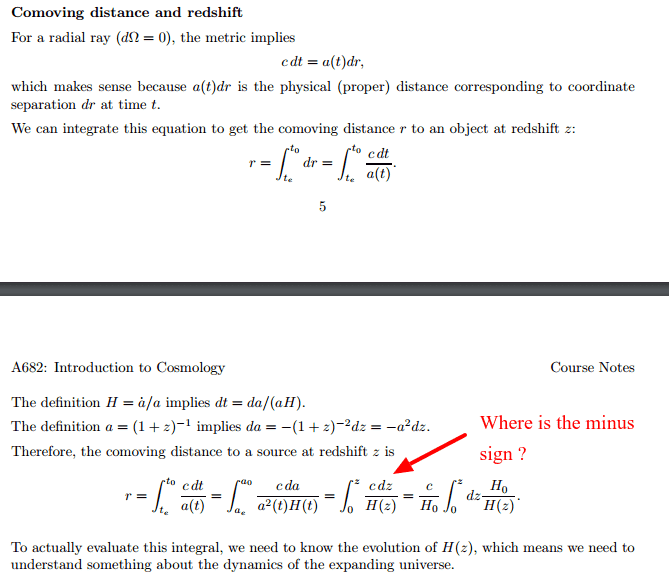

Hello PhysicsForum,
There is something I don't get at the end of this course notes PDF file. In the last section, titled "Comoving distance and redshift", which I have copied below, we have a short derivation of the comoving distance and redshift relation.
Almost all is well, the only thing that troubles me is : why is there no minus sign after da has been replaced by -a2dz ?
I have searched the web and found almost identical derivations in other courses or publications, but I never read the explanation for why the minus sign drops. I have found what seems to be the source material for most of those derivations : this paper from 93 (see section 6.3, "The General Redshift-Distance Relation" on 3rd page). It is referenced quite often by others when this comoving distance and redshift relationship shows up.
Maybe I am just missing some mathematical trick ? This is not super important of course, but it bugs me.

Could it be because the integration limits have been swapped? (consider what it means when the limits are ##a_e -> a_0##, where e stands for emission, and ##0 -> z##.)
Yes. The change of variables leads to two minus signs which cancel one another: ##da = -a^2 dz##, and reversing the limits of integration.

Thay's what I thought, but then it means that the ae limit corresponds to z when you do the change of variable, and a0 to 0 redshift ? Sounds weird, shouldn't it be the other way around ? Since a0 = a(t0) is the expansion when we receive the redshifted signal.

This is probably easiest to see if you look at the equation for the scale factor in terms of the redshift:
[tex]a = {1 \over 1+z}[/tex]
Here note that for ##z=0##, ##a=1##. That's the current scale factor and redshift. A far-away object, at, say, a redshift of ##z=2## is at a scale factor of ##a=1/3##. The integral above over ##da## would integrate from ##1/3## to 1, while the integral over ##dz## integrates from 0 to 2.

Think of how far you need to look. Higher z is seen farther than lower z, while lower a is seen farther than high a.

Makes sense now. Thank you !
