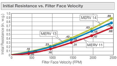

Have a look at this graph here relating filter face velocity to the resistance for an air filter( Specifically, these ones). I would hypothesize that the resistances from the air filters would add up something similar(not necessarily same) to resistance of resistors in a parallel circuit, so that the total resistance at a given air flow is lower than the resistance for each individual air filter. The total resistance-airflow graph of the filters would be flatter and therefore its intersection with the fan curve of the axial box-fans would be at a higher airflow.

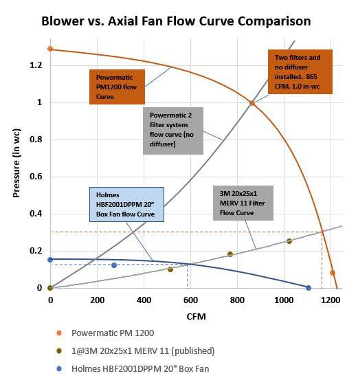

(Here is a page explaining how that works: Skip to figure 6 for explanation. I'll also post the relevant image:)
The point where the filters Resistance-Airflow curve(grey), intersects with a fans (static)Pressure-airflow curve(blue line is an axial fan, Orange line uses a centrifugal fan), gives the CFM the air cleaner will have(while the filter is still new at least).

There is no Venturi effect.
WilburWonka said:
and the air pressure is four times higher at the Comparetto cubes filters' interfaces(Venturi effect)
and that part is incorrect.
You can see that from the blue curve.
At maximum pressure that the fan can produce ( looks like 2.2 in WC ), there is no flow.
That would be maximum resistance to flow, ie cutoff.
As resistance decreases ( assume you unblock the fan and keep adding more filters ), fan pressure drops and cfm increases.

Thank you all for your responses. In summary, from what I have taken from the answers here, I take this to be the explanation:
The use of 4 filters increases the Filter face area(the box length and width of the filters- no stretching out the pleats) of the filter medium by 4, so the Filter face velocity(which is the Flow divided by the filter face area) is now a quarter for the same CFM air flow. The filter face velocity for the cube setup would therefore be a quarter of that for the 1-filter setup for the same cfm, and it would therefore have the corresponding lower resistance for that reduced face velocity(given by initial resistance vs filter face velocity chart).
As for the filter flow curve and fan flow curve intersection, which will determine the airflow from the air cleaner: the cube filters graph is basically like its been stretched 4x in relation to the y-axis. It intersects with the box-fan(axial) curve at a higher air flow rate, explaining why the cube type air cleaner has a better airflow performance(despite the low static pressure capabilities).
The Venturi effect doesn't apply here as per Russ's explanation.
The chart relation for resistance and face velocity is approximately Resistance = constant*(face velocity)^2, though this might differ between filter type and manufacturer.
