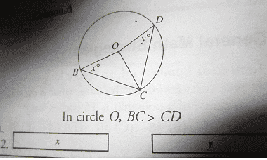

In summary, the homework statement states that BC is greater than CD. However, the attempt at a solution reveals that both triangles are isosceles, meaning that x and y should be equal because they are both opposite the radius. However, the book states a different answer, stating that x is greater than y.

In circle O , BC >CD
Compare x & y (which is greater?)
There are no eq. Rule: angle opposite larger side is larger
In my view both triangles are isosceles triangle. So x & y should be equal because they are both opposite the radius
But book says a different answer. Some body please guide me.
Zulfi.

Also compare ##\angle BOC##and ##\angle COD##, which is greater ?
Since its given that BC is greater therefore, arc BC is greater so angle BOC> DOC. But I don't know about x & y? Only that they are opposite to radius so they must be equal.

Right. So can you write x in terms of angle BOC and y in terms of DOC?

There is no such rule. E.g. consider B starting near C and moving around to be almost opposite C. At first, x is nearly 90o; half way round it is 45o; when opposite it is 0.
The angle subtended by a diameter is always a right angle. Maybe you are thinking of that.

<So can you write x in terms of angle BOC and y in terms of DOC?>
Based upon my understanding:
x + <BOC +<BCO = 180
or <BOC= 180 -2x
<DOC = 180 -2y

Correct.
So x=? and y=? (in terms of BOC and DOC). If x and y were equal, BOC and DOC would also be equal. But BOC>DOC, meaning x and y are not equal. Which one is greater then?

$$x = {180- \angle BOC \over 2}$$
$$y = {180- \angle DOC \over 2}$$
Now which is bigger ?

From these equation it looks that y is bigger. But you have derived this eq based upon my work and i used the logic that ∠x is equal to ∠BCO because BOC is an isosceles triangle and ∠x is opposite to OC. Similarly ∠y is opposite to OC, so its astonishing that ∠x & ∠y are not equal?

Yes, BOC is isosceles, with OB=OC, so angle OBC=angle OCB.
Likewise, angle OCD=angle ODC.
But these are two different isosceles triangles; there is no rule that says they must have the same angles as each other, even if they have the same lengths on some sides.
Simple experiment: draw a triangle with sides length 4, 4, 7 and another with sides length 4, 4, 1. Each has two equal angles, but that angle is very different in one from the other.
