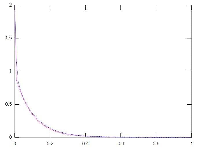

Then, I get the following graph for the approximations $(x^n)^2+(y^n)^2$.
The graphs are approximately the same, aren't they?
How can we deduce from this graph which method is better? (Thinking)

I'm not sure if we can say all that much from the graph.
The best I can come up with, is that we can expect the graph to be smooth, so the red graph can't be right.
And we can expect the trapezoidal graph to be most accurate, since it's a 2nd order approximation.
So we can compare forward Euler and backward Euler with each other by looking how close they are to the trapezoidal graph.
Or if we add the graph of the exact solution, we can compare all methods with that graph.
It would be best if we subtract the exact solution from approximations before plotting them, then we see directly which one is best, since then we'd actually be looking at the errors. (Thinking)
Or instead of the exact solution, we can use Octave's ODE solver (which will use some variant of Runge-Kutta) to find:

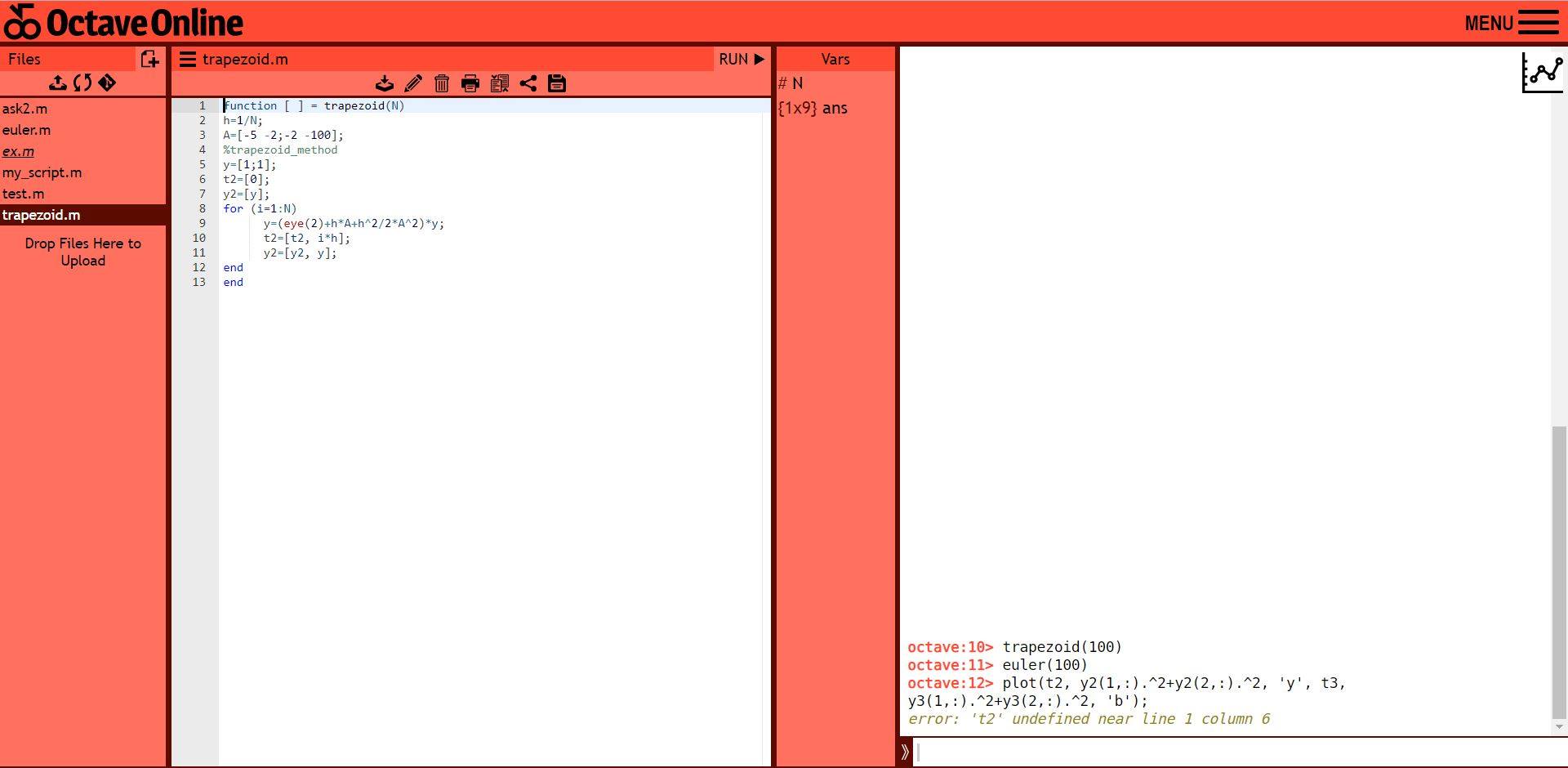

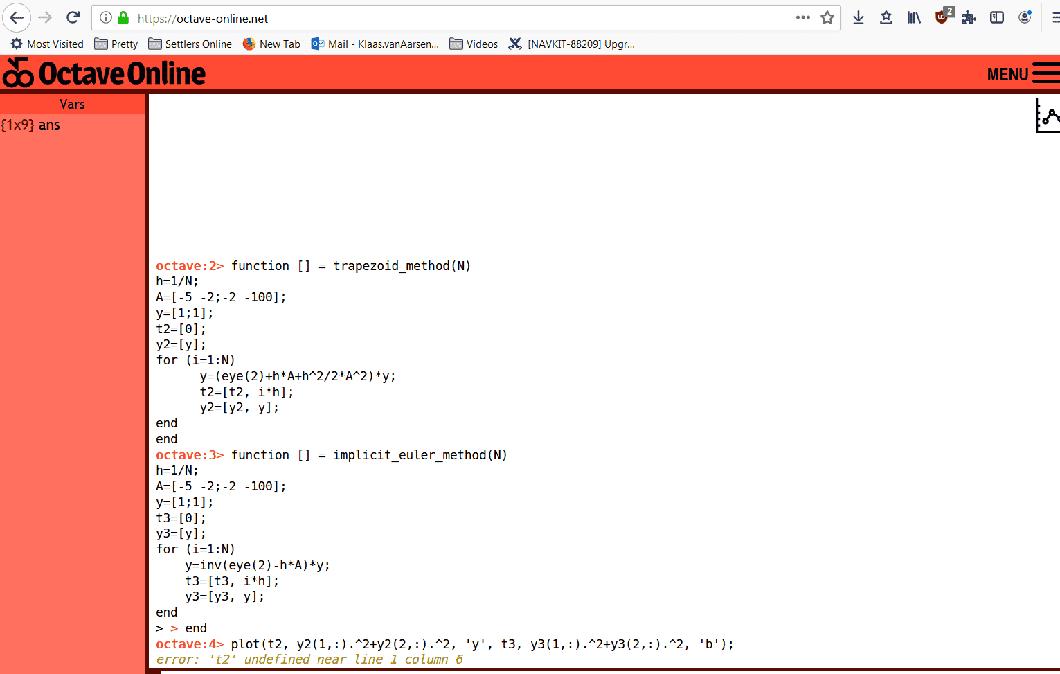

I have written the following code for the trapezoid method:
Code:
y=[1;1];
t2=[0];
y2=[y];
for (i=1:N)
      y=(eye(2)+h*A+h^2/2*A^2)*y;
      t2=[t2, i*h];
      y2=[y2, y];
end
So is something wrong? (Thinking)
Looks fine to me.
What do you think is wrong with it? (Wondering)

I thought it was wrong, because you said that the red graph can't be right and I thought it corresponds to the trapezoid method. But now I saw that it corresponds to the forward Euler method. But I think I applied it correctly. Is the red graph maybe like that because this method isn't exact enough? (Thinking)
Indeed.
It wouldn't be exact enough, showing a graph that is not smooth (it has a bend in it) even though the other approximations do seem to be smooth enough. (Thinking)

Ok. But why isn't there a difference between the graph of the trapezoid method and the graph of the backward Euler method, although the first one is a 2nd order method and the latter a 1st order method? (Thinking)
Wouldn't that be because backward Euler is also less exact than the trapezoid method? (Wondering)
But how is this seen at the graph? (Thinking)
I don't think we can.
Not unless we compare it with either the real solution, or a better approximation. (Thinking)

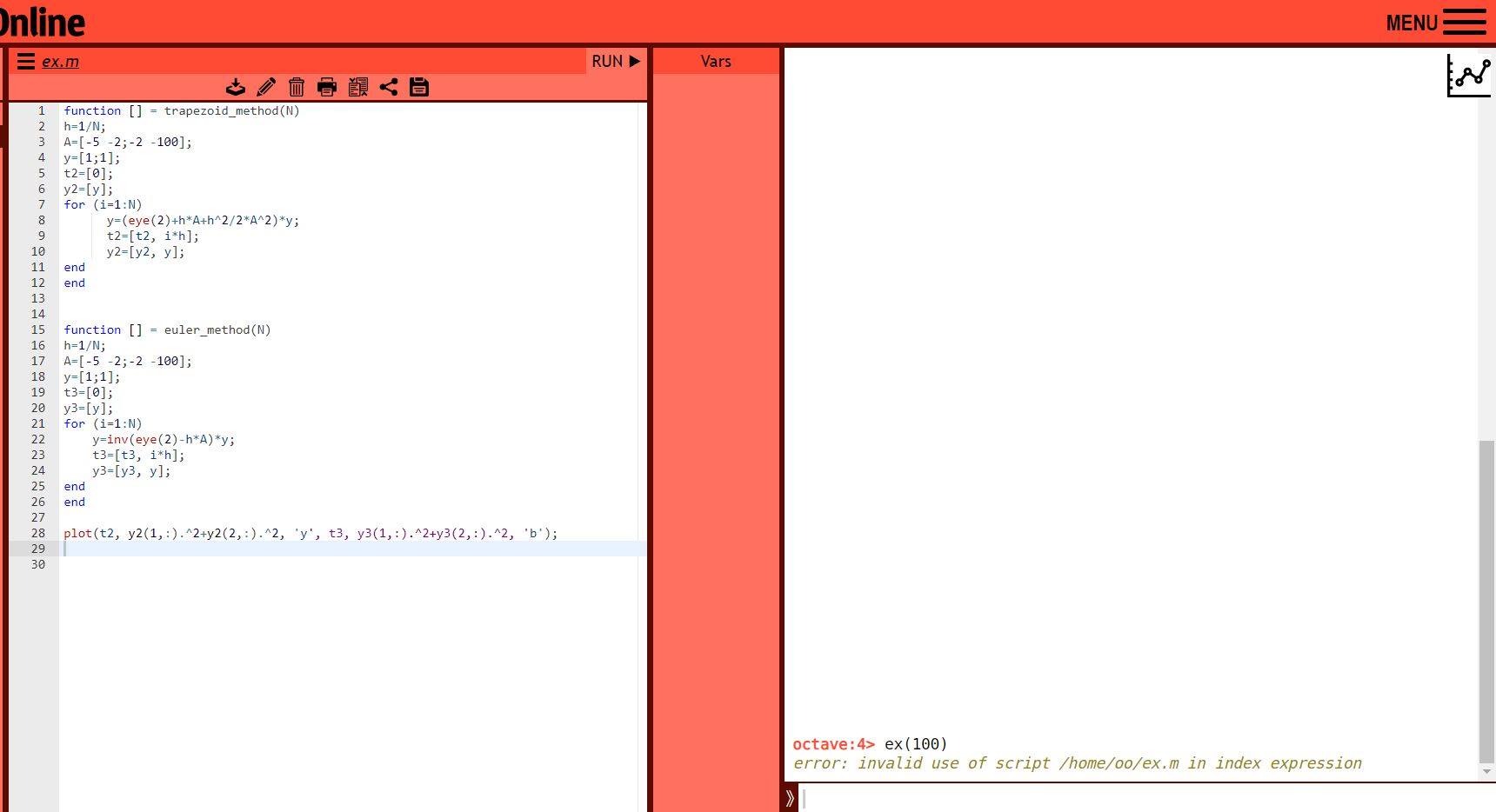

I tried to plot the following code but I get the following message:
"error: invalid use of script in index expression"
What does this mean? (Thinking)
The code is the following:
Code:
function [] = trapezoid_method(N)
h=1/N;
A=[-5 -2;-2 -100];
y=[1;1];
t2=[0];
y2=[y];
for (i=1:N)
      t2=[t2, i*h];
      y2=[y2, y];
end
Code:
function [] = implicit_euler_method(N)
h=1/N;
A=[-5 -2;-2 -100];
y=[1;1];
t3=[0];
y3=[y];
for (i=1:N)
    y=inv(eye(2)-h*A)*y;
    t3=[t3, i*h];
    y3=[y3, y];
end
plot(t2, y2(1,:).^2+y2(2,:).^2, 'y', t3, y3(1,:).^2+y3(2,:).^2, 'b');
At first look it seems to me that the problem is that the functions do not return anything.
The variables inside those functions, that are assigned values, are local to the function.
So when you plot those variables, you'd get an error because none of those variables have an actual value. (Worried)

  • #32
Klaas van Aarsen said:
I tried:
Code:
t2=[1 2];
y2=[3 4; 5 6];
plot(t2, y2(1,:).^2+y2(2,:).^2, 'y');
That works... (Thinking)
Did you perhaps put those functions in script files?
Or are you running the code on the prompt?
Btw, your current functions are not syntactically correct since 'for' has an 'end', but 'function' does not have an 'end'. (Worried)
I wrote that code in a script .m and when I run it it is asked to enter a value for N. I give for example 100 and then I get the error message.
I did that in https://octave-online.net/
So, when you run that code it is executed normally without any error? (Thinking)
  • #33
If I copy and paste your code in octave-online, I don't get any response. (Worried)
I expected that since those functions are not terminated with the [M]end[/M] that should come after. (Nerd)
What did you put in octave-online exactly?
How did you get the error? (Wondering)
  • #34
There are two functions that I want to plot. Here you can see the functions I wrote then I press RUN and enter 100 as the value for N and as you can see I get again an error message. What have I done wrong? (Thinking)
  • #35
If we put a function into a file named [M]ex.m[/M], then that file must contain exactly a function named [M]ex[/M] and no other statements.
Since that is not the case, we get an error that is unfortunately not very descriptive. (Worried)If we copy and paste your code into the regular command prompt of Octave online, we get:
Now we get the error that the variables are not known as I explained. (Nerd)Alternatively, we can create a new file named [M]trapezoid_method.m[/M].
Put the code of the function in there, and only that function.
Click the save button.
Type [M]trapezoid_method(10)[/M] on the command prompt.
Now it will execute the function as desired. (Happy)
  • #36

Then in the command line I wrote the following commands:
octave:1> trapezoid(100)
octave:2> euler(100)
octave:3> plot(t2, y2(1,: ).^2+y2(2,: ).^2, 'y', t3, y3(1,: ).^2+y3(2,: ).^2, 'b');
but I get again "error: 't2' undefined near line 1 column 6". What am I doing wrong? (Thinking)
Here's how it looks like at me:View attachment 9069
  • #37

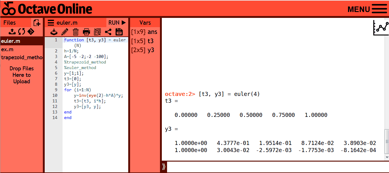

(Emo)
I tried it like that. The command "[t2, y2] = trapezoid(100)" works. But the command "[t3, y3] = euler(100)" seems not to work, I get the following:View attachment 9070(Thinking)
  • #39
It seems to work for me:
(Wasntme)
