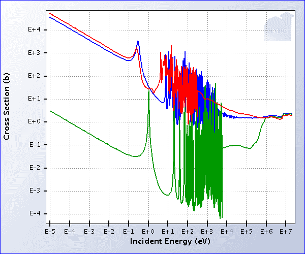

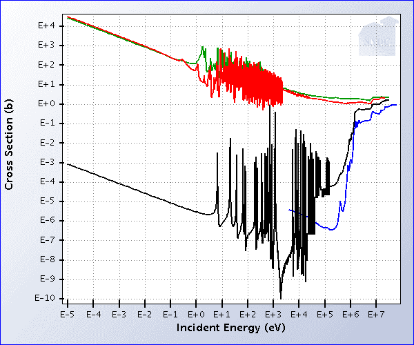

Fast reactors are different animals from thermal reactors. Fast reactor fuel usually has greater enrichment to compensate for the lower fission cross-sections in the fast energy spectrum.
Even so, the fissile/fertile elements are the same, but in a fast spectrum, the fertile nuclides are nearly as likely to fission as fissile nuclides - in the fast energy range, although the fissile nuclides still have a higher cross-section (probablility) for fission in the resonance energy region.
See - http://www.nndc.bnl.gov/sigma/search.jsp
See attached - cross-sections (n,f) for Th232 (blue), U233(green), U235(red), U238 (black)
Pu239(blue), Pu240(green), Pu241(red)
