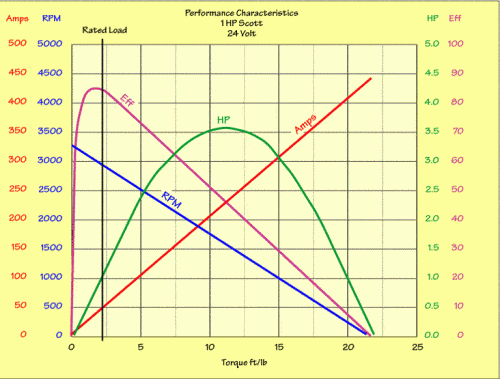

What matters is power output. Power is the rate of doing work, electric motors output peak power at a specific point.
Which ever bike happens to be geared to maintain it's motor closer to the peak power output will win.
If both bikes go 25 km/hr max on the flat they are both producing the same power (motor power output = power to overcome drag).
There are two cases that could explain this - both motors are at the same RPM and gearing (this can be achieved even if they have different sized wheels)
or - the motors are producing the same power but are on different sides of the peak power point.
In the second case when one motor slows, it's power output will increase as the RPM moves towards the peak power point and the other motor will decrease power as it slows and the RPM moves further from the peak power.
Obviously the later bike will lose (but if the race were down a hill the later bike would win..)
