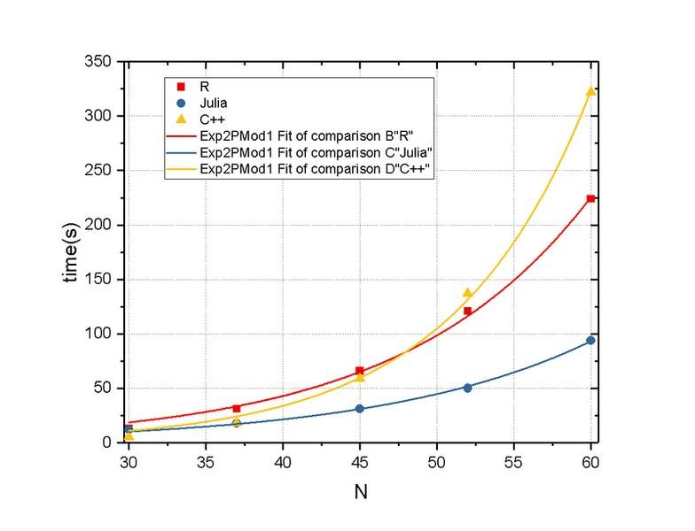

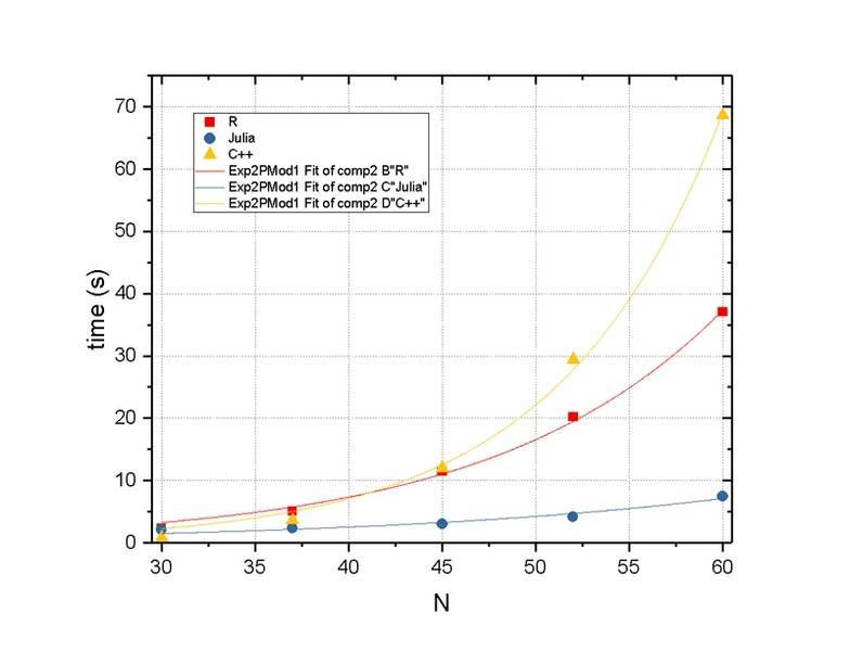

I did an experiment with calculating a numerical heat transfer (or diffusion) problem in 2D with R, Julia and C++ codes. The problem is like the one in this blog post I have written https://physicscomputingblog.wordpress.com/2017/02/20/numerical-solution-of-pdes-part-3-2d-diffusion-problem/ .
I made a square computational domain, which contained NxN discrete cells, where N was given values 30, 37, 45, 52 and 60 on different runs. The method that was used was implicit finite differencing. The number of timesteps was only 10 in all runs.
The C++ code used simple Gauss-Jordan elimination taken from the book "Numerical Recipes in C", and the Ubuntu C++ compiler was run with parameters "g++ -ffast-math -O3". There was no attempt made to use parallel processing, or to account for the sparseness of the linear system. The matrix inverse was computed only on the first time step, and simple matrix-vector multiplication was used in consecutive time steps.
The R code used the in-built "solve(A,b)" function for solving the system of equations.
The Julia code uses the backslash operator "A\b" for solving the system.
The computation times used by the three codes (not including compilation time) are plotted below for the runs done on my own (slow) laptop (AMD E2-3800 APU with Radeon(TM) HD Graphics × 4).
Next the runs were also made with my work computer (Intel Xeon(R) CPU E31230 @ 3.20GHz × 8), and the computation times are shown on the next plot.
First I thought that the Julia code is the fastest because it can somehow notice the sparseness of the matrix and use that to speed up the computation without being explicitly told to do so, but when I tried to invert a matrix filled with random double-precision numbers from interval [-1,1], it worked just as fast as the inversion of the 2D diffusion equation matrix did. So the Julia compiler can probably somehow automatically parallelize the code.
The C++ code would most likely be the fastest if I used some LAPACK functions for solving the linear system, but I haven't done that yet.
Note that if the computational domain has ##N^2## cells, the matrix to be inverted has ##N^4## elements.
Likes FactChecker and fluidistic
The slow speed of C++ is surprising (although I have more confidence in speed of C than C++). There must be some catch -- some difference in the algorithm. If you want to see if Julia is parallelizing the calculations, you should be able to see something in the performance monitor. If you really want to study it, you can use scripts and DOS commands to collect data. I can not believe that Julia is fundamentally faster than C or even C++ (I can believe a tie, and that would support what others have said about Julia.). C++ slower than R is completely unbelievable to me.
PS. I think you are seeing why people do not use complicated benchmarks for comparisons of greatly dissimilar languages. They involve so much more than the basic calculations and the algorithms are not comparable without a lot of work on specific computers.
Likes Telemachus and hilbert2
I would also assume that this is due to the the algorithm. Numerical Recipes is notorious for not having efficient implementations (although it is a great book to learn the basics, including the code supplied). You should try GSL.
