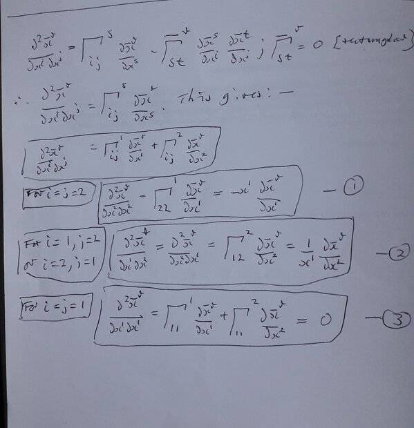

Hello TerryW,
I'm working through the questions in Schaum, but am struggling with 6.29. Using the method of Q 6.6 gets me stuck. I would be grateful for any tips on this.
Regards.
Phil B

Hi Phil B
Have you noticed that in Question 6.6, ##x^i## is rectangular and ##\bar x^i ## is curved but in 6.29 this is reversed?
This means that in "An Important Formula" (6.6) the barred Christoffel symbol belongs to the rectangular system and is therefore zero.
This gives you two partial derivative equations. If you can solve these analytically, you are better at maths than me! All I did at this point was to "guess" the co-ordinate functions ##\bar x^i (x^i, x^j)## and then work out all the partial derivatives needed to check that the two equations are consistent.
I chose to generalise the co-ordinate functions later once I had worked through the simple case of coincident origins/axes.
Hope this hint helps. There is one further pitfall you might or might not encounter.RegardsTerry W
I interchanged the barred and unbarred symbols in (6.6), so that the newly barred Christoffer symbol, which now applies to the rectangular system, is therefore zero, and the second term on the right disappears. This gave me three PDEs to solve, one of which had zero on the right hand side.
Hi Phil,
I didn't swap the barring in (6.6) and it worked out fine, but it also works out OK if you do change the barring (and it is a bit easier!)
If you don't want to bother with Latex, could you send me a photo of a page with your three PDEs.
RegardsTerry
Hi Terry,
I don't have Latex, so attach a photo of my working leading to three PDEs.
Hope you can decipher my writing!
Regards,
Phil

Hi Phil,
Your three equations are fine, but you need to take them another step forward. Put r = 1 or r = 2 into each equation making six equations in all.
When I used the original version of (6.6), the resulting equations didn't look like I'd be able to produce the required results for the relationships ##\bar x^i = \bar x^i(x^i, x^j)## so I "guessed" the answer and checked out that all my equations balanced.
The three (x2) equations you have produced using the version of (6.6) with the barring interchanged, leads to a set of equations which I now believe can be used analytically to produced the required results.
Note that the two equations derived from putting r = 1 and r = 2 into your equation 3 actually provide you with quite a bit of information about ##\bar x^i = \bar x^i(x^i, x^j)##!RegardsTerry
Thanks Terry. After a break from maths, I had another go at this and found that the answer in the book certainly agrees with my 6 equations. Not sure I would have got there on my own though!
Regards,
Phil
