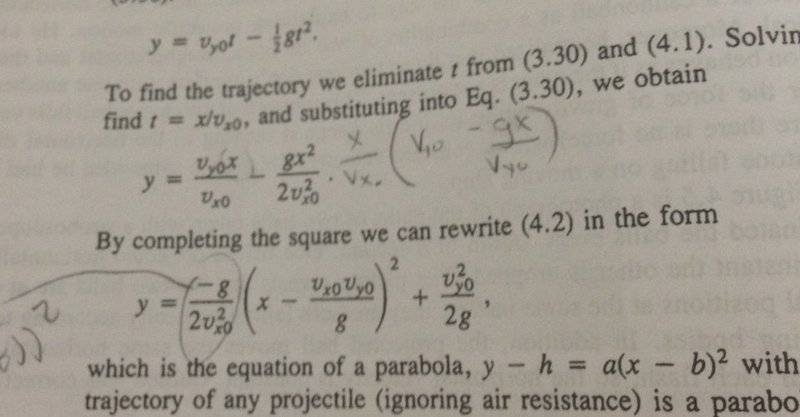

1. How did they complete the square for these equations in the picture below? What was their thought process?

1. In picture
2. ds/dt / d2s / dt2
1. It seems like it came out of thin air.

What is 2. in your relevant equations?
##V = d/t \to t = d/V##
You can add A and subtract A (equivalent to adding 0), and it's still the same.
##\frac{v_{y0}x}{v_{x0}} - \frac{gx^2}{2v_{x0}^2} + \frac{v_{y0}^2}{2g} - \frac{v_{y0}^2}{2g} ##
They factored out ## \frac{-g}{2v_{x0}^2} ##
Rearrange it and it might look a little closer.

V2y0/2g
How did you find that
Craig Scott said:
V2y0/2g
I assume you are asking about getting from the second equation in the image to the third.
Just expand the square in the third equation and simplify. You should arrive at the second equation.
